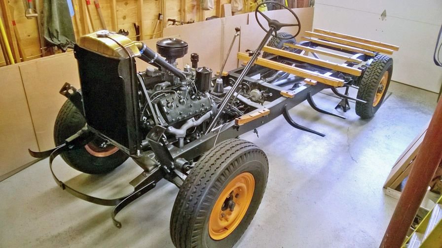

Does anyone have the dimensions for the wood blocks that mount the cab and bed to the frame? 1 ton is completely different than 1/2 ton and apparently not readily available for purchase.

I have some old pieces for the cab that could be used for templates. They came from a 39 express.
I am building a 1939 1 ton express

Try pm'ing Rustynut4247. He made those at one time and may still be able to. Note that 1938 and 1939 have different floorpans and different frames.

It is a 1 ton express pickup.
I will look up rustynut
Thanks for the help. It’s all the small stuff that really adds up.

I think a cabover would be very different. Google BRUCE HORKEY, he supplies complete bed hardware & info. I purchased from him a few years ago for my 47 Tonner Express.

Yes, cabovers are different. Todd at one time or another made most of the body to frame blocks for most 1932-1941 pickups and trucks.

Here is a photo from another member to illustrate what I am looking for.
https://www.ford-trucks.com/forums/1...l#&gid=1&pid=1
