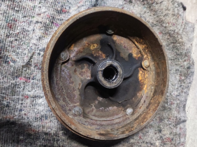

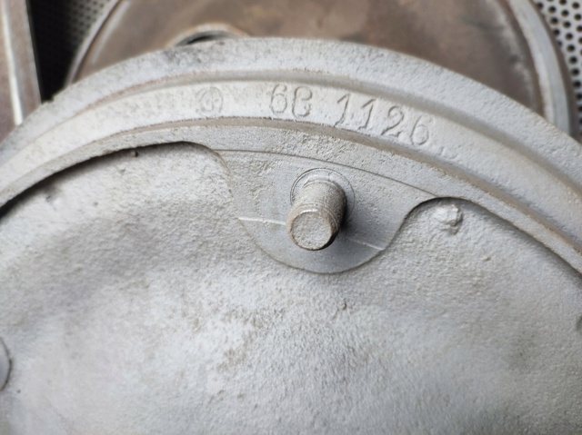

Hello, I'm trying to identify the origin of a pair of front- drums
From what I was told they came off of a '36 Matford V8-72, part number should be 68-1105-A2 just like the US '36 Ford. But they're stamped 68-1126-B
They have the star reinforcement like UK Ford Pilot
But have the ribs and part number starting with 68 like any'36
Juice backing plates fits, they have the same dimensions as '37/'39 drums and not like '36 drums
They use 1.5" shoes.
I don't find this part number in my Matford part catalog and it's nowhere in Ford's green book.
Does anybody has any idea?
Also what color were wide five drums and wheel painted?
