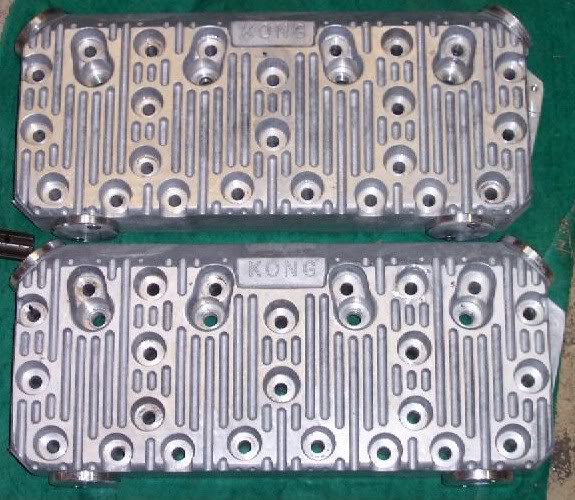

We'll need a little more information. Are these the original Kong heads or the reproductions now being made? If original, are they for single or dual plugs? Pictures of both sides of the heads would be helpful.

Originally Posted by ken-r-mer View Post
Have access to buying a set of unused Kong flatheads, but owner has no specs on the heads and have not been able to find specs, such as compression ratio, head CC, etc...
Look like these?

Single plugs and the plug holes are in the center of the block, not high up as in your pic. I'm running a Tom Roberts (TR) blower setup with a pr of the new Stromberg (BIG) 97's, so ideally looking for CC's in the mid to upper 70's and the CR in the low 8's max. The block I have has a 4" crank, 3 5/16" bore, Isky 77B (mild) cam, beefed up main caps and the block is relived. My alternative is Navarro blower heads. The Kong's show no signs of wear, head bolt seats are pristine as well as the underside. My guess is newer production run, as no signs of aluminum oxidation.
This?

Yes, but unpolished. Looking at them 1st hand the water jackets seem bigger than either Edelbrocks or even Offenhausers. My theory, more water, cooler running. An extra 1/2 gallon of water running through the system, the better. Also in additional research, a comment was made of recommending domed pistons.

Unless you can show us the chambers - hard to comment on them. Just about ANY head can be made to work with a blower . . . it just takes some work on the transfer area, around the valves, etc.. You'll want a tight quench above the pistons, but the rest of the chamber can be opened up to drop the compression to what you're looking for.

I agree with B&S above. We need pictures of the combustion side. I have seen these with deep chambers (probably for "pop-up" pistons), while others appear to be more "conventional". It would make a huge difference. The deep chambers could have been an anomaly, but who knows?

One thing I like about the Kong heads shown by the O/P is that they appears to have the spark plugs moved from over the exhaust valve (like Edmunds heads). This allows the use of extended tip plugs that I have found to be quite advantageous.

Tubman, The original location is between the 2 valves at the furthest point away from the cylinder. So yes the plug tip may clear the 2 valves.The later head plug location is closer to over the piston. I read somewhere, the closer the plug is to being over the piston the less advance needed.
