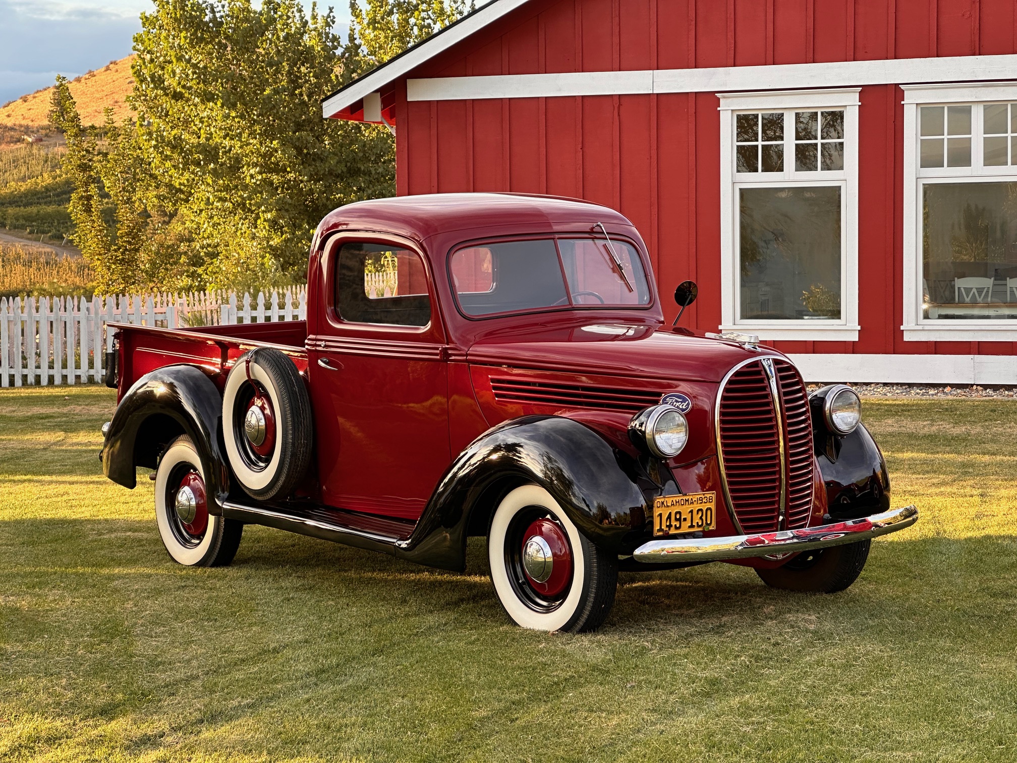

Hi everybody. My horn does not work. I am going to set about to rewire it. I have a great vintage AAAOOGHA horn that I want to install. However... I can't find any resources online with photos/video for a 38 Ford truck horn. If anybody can point me in the right direction, it would be greatly appreciated.

A '38 truck horn is just a simple "beep" horn and they are fairly easily obtained with a want ad here on the Fordbarn.
Nice truck by the way. I like it.

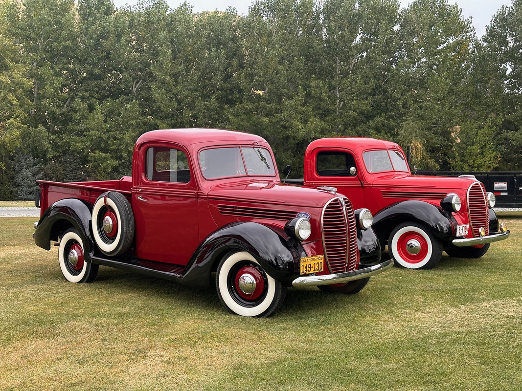

Thanks for the complements! BTW she has a twin sister that is a 39. I am wondering if I should take the steering wheel apart and try to figure out the wiring inside of that, or just install a horn button on my dash. I hate cutting holes in metal though.
I actually already have the horn, its a vintage ANES aaogha. Sounds great bench tested. Just trying to figure out how to get inside the steering column and where all those wires will be going.
