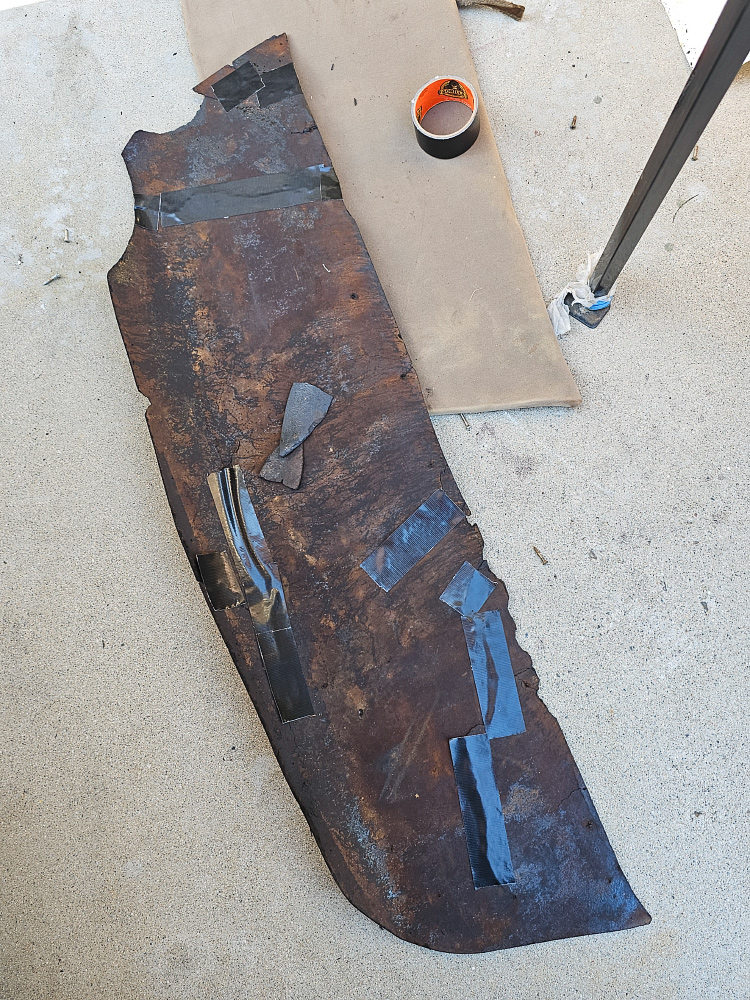

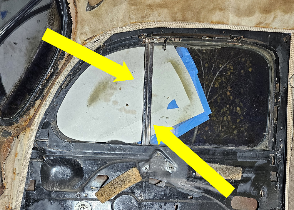

Package Tray: My package tray 'cardboard' is the typical super fragile breaking apart. Thankfully, I was able to piece most of it back together to get a template. What are you all using for package tray replacements? A thick cardboard? Same goes with some of the cardboard fabric barriers that are along the back between the quarter window and the rear window.

I bought my 1940 coupe vent window rubber seals from DRAKE many years ago. I think he still sells them. When I installed my LeBaron-Bonney upholstery kit in 1977 I did not install any cardboard between the rear quarter window and rear window. There was a flexible metal support rod that held part of the headliner in place to form the curved "sail panel". I made my own package tray out of finished plywood. I think it was 1/2 thick.
So the cardboard I'm mentioning is here in the photo below. If it's not necessary to reinstall, I don't mind leaving it out. It was screwed into the body in two spots. Is this original for the 1940 Ford?
And as far as the package tray goes, mine wasn't even screwed into the back tack strip, it was just sitting there. It appears that it should be screwed down like yours? And it curved upwards slightly towards the rear windshield. Should it be completely flat? (you can see the upward curve in the above photo)

Here is a very helpful thread on the 1940 package tray installation. The one piece tray should fit flat.
Be sure to read both pages.
https://www.fordbarn.com/forum/showt...d+package+tray
If you do a Fordbarn SEARCH on 1940 Ford Package Tray more info appears that you will like.
