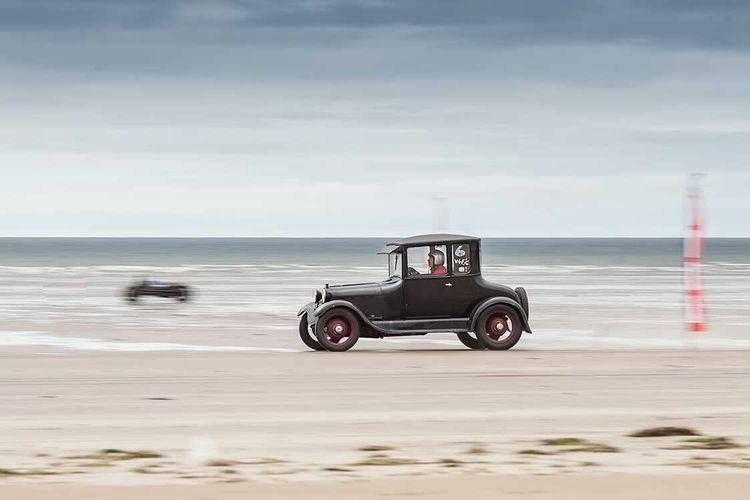

Just to say - I really like my Brierley head.
It pushed this down the beach at 74mph...

Hot, have you done anything else to the engine other than HC head?

Ported B block, Stipe 340 cam, reshaped stock size modern valves, 97 on a Burns manifold and a Snyders cast iron header.
74 is at the end of a half mile sprint and with 3.27 gears it's still pulling at that...
