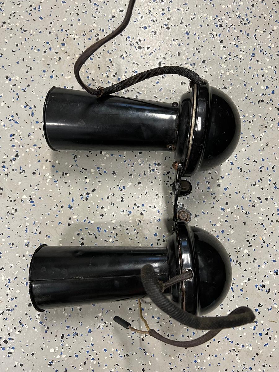

I have my horns off my 37 deluxe coupe to clean the contacts and make some adjustments before I repaint them. They are identical in size. After testing them this morning, the one with the cup washer and hex nut is the low note. The other one without the cup washer is the high note. I hope this helps. Nate Anello

Could you please measure the length of your horns? I'm now wondering if the one horn I have is even correct for '37.
That does seem to support my thought that the Standard uses the low tone, which would sound better than the high as a single tone. Then the added high tone on the Deluxe produces an even better sound, when added with the low.

Your horn's trumpet does look to be be longer than those in Pete Hoovie's photos in #6 above (which appear to be correct). Part of the reason may be the shape of your horn's trumpet is different than the typical '36-'37 Sparton horn trumpet.

Yes, they do appear shorter than mine, but the bracket is different, so I wonder if those are actually '37? If I had the front together, I could measure to see how long they would need to be before interfering with the pan. But as of now, I guess I'm looking for 2 horns

I'm going to have to agree with David G that what you have is a longer horn. My horns measure 9 3/4" total length. My horns look identical to Pete's as you can see. Let me know if you need something else. Nate Anello

Here are a couple pictures of the two horn bracket for the deluxe. There are rubber insulator washers that mount between the two horn mounts brackets.
