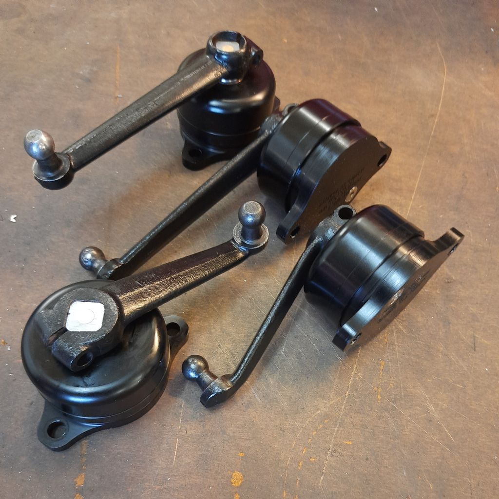

Supplied a few old shock parts to a friend of mine who runs a machine shop across the way from work. They do prototype machine work for a competition shock absorber company. Been following his latest inhouse project since then. The first prototype was run on a metal shaper for a 100 hours or so. After a few design tweaks he ran off a set of ten for some on-road real world testing.
Popped down the other day to see them after they'd returned from the anodisers. This is one from the set that I'll be testing. Mmm - lovely. Guess I'll be driving the Coupe every day soon once I've sorted out a set of shock arms to fit. I'll update this thread when they're ready to fit.

So the body is aluminum?, it looks like the shaft is steel, but the vanes look aluminum, is there more holding the inner cover on than the 2 bolts?, I would think the holes in the cover would prevent controlled flow/ resistance, how close will you be able to get the action of property working originals

The body and cap are aluminium, threaded together. The rotor and vanes are one piece in steel and run in bronze bushes. The holes are ports for internal reed valves which can be designed to suit the damping required. More damping for racing, or a flathead? Less for a lightweight speedster? No problem.

There's a fair amount of secret squirrel stuff happening in there that they didn't want me to share so I didn't take pictures of all the components. I think I convinced him that remote rebound adjustment might be a tad niche.

As promised, I managed to find plenty of single track potholed roads over the weekend. So after 800 miles or so, I returned the shocks to Craig who stripped them down to assess for any wear or damage that I’d managed to inflict. As it turns out – nothing. No oil leaks, the seals worked perfectly, bearing surfaces were unmarked, and the shim packs had been functioning perfectly. Re-assembled and repressurised with oil, they were returned in time to fit them to my Tourer for the trip to Prescott hillclimb for GOW!

So, about those shock absorbers. They're an aircraft aluminium bodied shock absorber with a steel rotor running in plain bearings, and proper internal shim valves much like a modern telescopic in action. Each unit is fully evacuated before being pressure filled with oil. In the past month or so, I’ve put probably 1200 miles on them. They just work. Really, really, well. No leaks as expected. A vast improvement on the last set of new shocks I fitted where one started leaking within a day or so of fitting. The damping action is smooth and instant with no shudders or shimmies. The machining quality is superb. Mine were supplied in a smooth topped black anodised finish which has held up very well despite a few miles of salt water driving on the beach. Dimensionally they’re a perfect interchange with original Model A/B ones. I’ve fitted original forged arms to the set I tested, with the stock mounting bolts lining up perfectly with the chassis. Externally they look stock but functionally they’re a world apart.
After my best attempts at breaking them, RKE are now looking at tooling up for production and will be taking pre-orders soon. Suitably impressed? I’ll certainly be saving up for another set.
