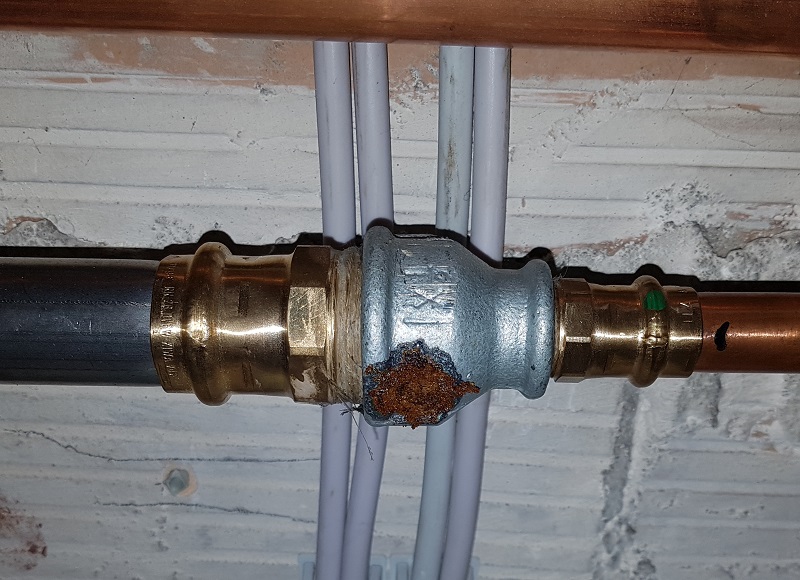

My problem is that I installed new stainless steel water pipes in my house a year ago. A component that made the connection to a provisional water pipe was also new and made of galvanized cast iron. This component has completely rotten from the inside in a year, I had to replace it with a stainless steel part a week ago.
If I now consider that the radiator or the head gasket decomposes due to a stainless steel pipe in the cooling system, I would rather stick to normal metal ...

No, it is not common. It's another system, like copper and PEX. These systems are also used here. With copper pipes, however, there is a possibility that the oxide will be deposited in the water and this will then have a bad taste. PEX is a system that is processed IN walls, and on walls, stainless steel has proven to be the neatest option. But it is also one of the most expensive systems on the market.
Here is a picture.
All parts installed a year ago. The stainless steel was like new on the inside, the copper as well ... The cast iron part was almost completely clogged on the inside and rusted from the inside out.

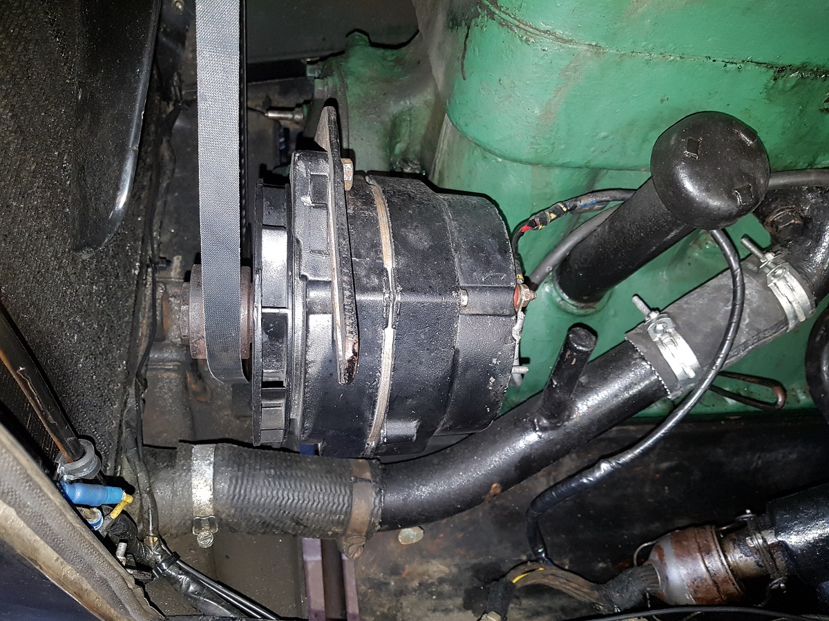

The last pipe lasted 90 years and that ain't bad, so why go to all the expense and effort to have a stainless one made or to buy one that costs so much more?
I actually see it the same way as you do. A new pipe will last longer than I grow old. But the new pipes all look so misshapen. They fell on the arch like this. I don't like that, it's not the same with my pipe. I also need the additional connection for the water heater. I would also have to convert the new pipe. My friend's stainless steel tubes have bends that are not as sunken / look like this. You could build the whole thing optically nicer. Ultimately, it's all about the look and durability.
Today I had the original pipe repaired for the first time. It will last 1-2 years, but then a new one will be needed.
Thanks Bob, I think I'll have the replacement made of stainless steel. The price for this will be relatively low, that's what a good friend does.
Here you can see the original pipe again.
Greetings Andy

I am not familiar withthat pipe. What is teh small black tube sticking up from teh main pipe, return connection for hot water heater?
30 Closed Cab PU is offline   Reply With Quote
Old 05-04-2020, 02:58 PM   #18
DRG-ler
DRG-ler's Avatar
Join Date: Dec 2018
Location: Berlin / Germany
Posts: 182
Default Re: Stainless steel water pipes?
..return connection for hot water heater?
Correct. The pipe was prepared by the previous owner but not used. I will now connect the water heater return. I'm currently installing it, but I don't want to reveal too much yet and don't show any pictures yet. Only when it's done.
Andy
