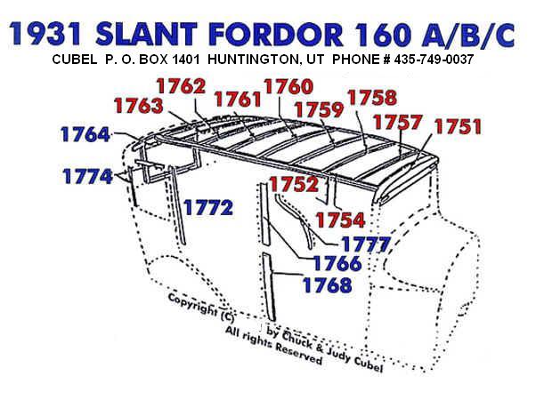

If you mean a slant window fordor, it has wood for the windshield header and the top. It's all steel without structural wood.

Just some basic wood in the body for the interior to tack to. Not structural. That's on the fourdoor.

Charlie and Arlen are right...but if you have to replace the header...get ready for a job.
