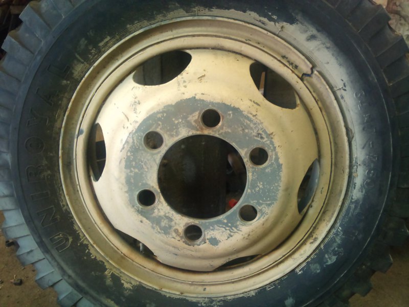

Hello y’all I just bought a 1951 F5 Ford and I’m a little worried about doing anything with the wheels due to the “widow maker” stories I’ve seen. Can you tel if these are the Firestone “widow maker” wheels? I’ve seen some mentions of other wheels that can be used instead but want to find a set of wheels with similar size. Anyone know of good option? Sorry I did a search but thought this might give me direct info. Thank you

If they are the two piece rims then yes. If the have just the outer locking ring which yours look like from small picture I see, then they can safely be worked with. A safety cage or other methods to secure them when inflating them is a must.

Pictures are a bit small to see but no, they don't look like the true "widowmakers". They look the same as the lock ring wheels I have on my bale wagon converted from a 1946 Ford truck with 20 inch wheels. A one piece lock ring holds the rim together. I've changed tires on a few of them. So far, so good. The 17 inch wheels on my 49 Merc do appear to be the "widowmakers" and I have not attempted to work on them due to their reputation.

The wheels shown in #1 of this topic are the Firestone type which were in common use until late '70's on light/medium duty trucks. This type of wheel is not the infamous 'widow maker'
The two piece rim with the center lock ring similar to what 'petehoove' posted are the problem type.

The wheels pictured are absolutely the Firestone RH-5° widow makers.
What stopped the RH-5° was threat of government recall. The NHTSA and IIHS were well along with the recall effort when in 1972 the wheel companies agreed to stop selling them. Sales materials for Budd, Motor Wheel, and Accuride ceased their listings in 1972. It took K-H until 1976 to comply. Stu

The AR, R-5, and RHP-5 are lock ring.
Only the RHP, RH-5, and RH are two-piece split, and of those only the RH-5 is known as the "Widow Maker".
This is the correct statement. Unfortunate for Ford guys most early bigger models (ton and 1.5 ton) have the RH, and 50s/60s era 3/4 and one tons have the RHP. Both have the solid/unbroken rings that must be squeezed over their respective base rim lips. Fewer and fewer shops anymore are willing to service them because so few remain in service, and shops haven’t trained techs in their handling. Ham fisted handling can ruin a ring rendering the customer screwed. Most bigger models 1948 to the early 1970s came with the RH-5°. Stu
