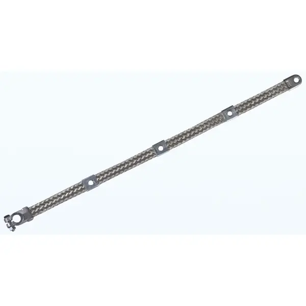

Default Re: Where to get extended ground strap?
I purchased the Deka p/n 01051 braided 4-hole ground strap from Blain's Farm and Fleet. If you don't have a Blain's near you they will ship it. You can check it out here:
https://www.farmandfleet.com/product...W_7BAzhk&gQT=1
