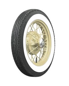

The tire question is easy, they are not road worthy. I have heard several answers about the life of tires and none of them were more than 10 years under the best circumstances.

Tires! Definitely check the tires. (a nice way to say ownership past 64 years and no (new) tire change... car is in line for new tires! imo, old tires is not road worthy!)
Back in High School days... all of our Model A's were daily drivers! Often we were just happy to get another tire if one was needed. round, some tread and right wheel size made for a winner! But today these times have changed. Good road safety, tire-wise, suggests tire replacement at 3 years or thereabouts no matter how much tread depth is remaining. Modern roads and hiways are tuff on tire rubber! Not to mention or overlook hazards in the roads. Many cities will never get all their pot holes fixed. I see many down here on my modern car daily driver outings!! Town roads and freeways! I know of one road section here that even a new Caddy will rattle!!! lol
When thinking about tires for Model A's the thoughts and advice of two good friends, long-term, experienced Model A'rs come to mind.
1) Life-long Model A'r, restorer and excellent mechanic. I recently was talking to him about tires for Model A's. He said: 'depends on if you plan to just drive it around the block and through the neighborhood now and then or...! (as such, then the choice is simple...)
2) Long-term Model A'r. Passed on. Had early A's and couple Ford V8 cars; 1936 Ford slant sedan, original engine. Owned a dedicated shop for Model A's for his own use! I was talking to him one time about Model A tires and he said, "... now they have radial tires for Model A's - 21" and 19." Bit pricey compared to some such as biased ply, but these days the tires we buy new for our modern cars are close in costs. For speeds over 40/45 mph sustained and long trips beyond home to high school and back... I would want best tire out there for my Model A 'daily driver'!
Radial Tires - Model A Fords
