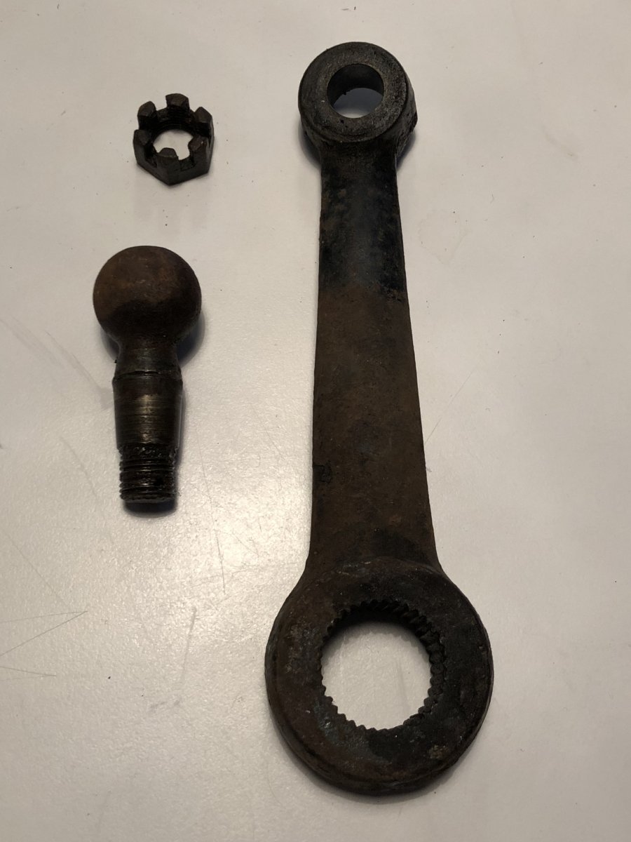

my4dv8,
This is what i found. The 32 BB pitman arm is close to you in the picture, more rusty.

Default Re: 32 commercial truck steering box
The unfortunate aspect of both those Pitman arms is that the ball is a parts of the arm, unlike the '32 passenger and commercialal arms which have replaceable ball studs.
I assume these are longer than a passenger arm. I am sure if the fixed ball is worn ,with some care it could be built up, or it appears that the is enough metal to make a 7degree tapered hole for a bolt in ball?
