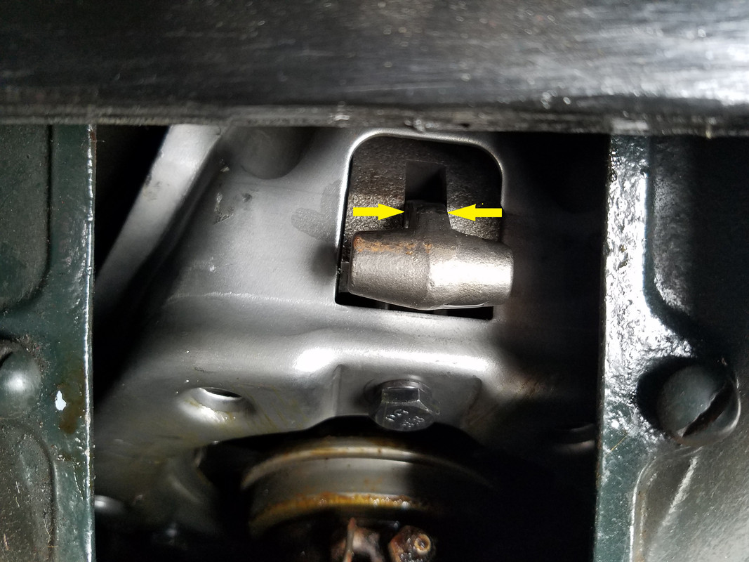

OK...problem solved, at least temporarily. I found that when I removed the access plate into the bell housing I could see the pressure plate finger pivot points, and hear the squeek quite well. I very carefully applied a couple of drops of oil on each of the finger pivots, and as I did that I could hear the noise beginning to fade. Once I got all of the finger pivots oiled, the noise was gone, and to my surprise the pedal felt a little easier to press as well. I don't know how long this is going to last, but I just wanted to let you all know what I found. Thanks for the suggestions.
