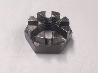

This is what the correct castle nut looks like....
49-54 Ford Spindle Hub Castle Nut
That's exactly right. The online vendors show a picture that looks exactly like that but say up to '48 so I'm not sure.

From memory, the early ones are tall, and later ones are short with a larger wrench size, like whats pictured. I should have one. Whats the wrench size ?

A brief search shows me an old tall one, 1 1/8 wrench, and the short one, .590 tall, takes a 1 1/4 wrench, but both are 3/4 16 thread. 3/4 20 is odd, not listed on my tap and die chart on the wall. could be the difference?

Q: Are the large spindle castle nuts all the same?
A: No. There is two different nuts for the early Ford spindles. 1928-35 Have a larger (taller) nut. In 1936, Ford went to a shorter castle nut. All threads are the same (3/4-16) See > Q&A's at https://prewarford.com/blogs/technic...identification
