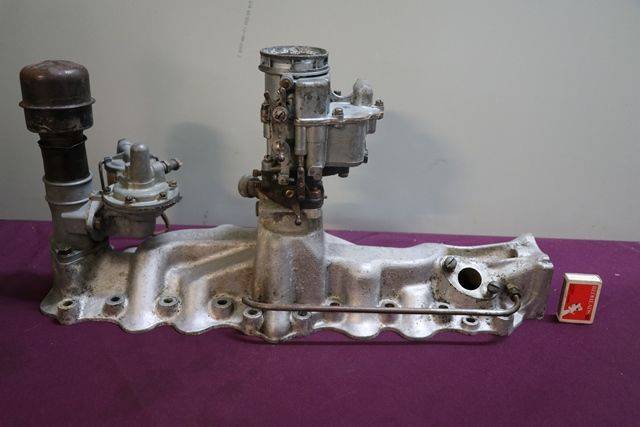

Hello, Did anyone ever see an intake manifold like this. Has a block off plate for something. Its on a 1936 V8 with water pumps in head and 21 studs.

NOT a '36 intake that's for certain.

I had one like that years ago and was told it was unique to Canadian flatheads and/or military...

I had one like that years ago and was told it was unique to Canadian flatheads or military...
This ^ , and COEs. Oil fill stack. Also, '36 intakes were aluminum.

[QUOTE=petehoovie;1985907]I had one like that years ago and was told it was unique to Canadian flatheads and/or military...
That's it! Now, thanks to you, I recall. I had a couple NOS aluminum and they were definitely Canadian military.

One other point...The generator mounting stud is too low for 35 or 36.

Funny you say that. Was having trouble with fan blade either hitting radiator or water pumps
