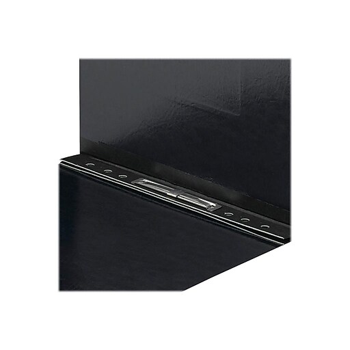

Keep in mind that original frames had two holes at each side in the corner for insertion of a metal "keeper." The keeper is akin to the old fashioned notebook page fastener where in this case, the metal tang penetrates the fabric and pulls the cover up tight on the underside into the corner of the frame. The outer layer folded back over covers all (although for fine point the judges may feel for "bumps" on top from the metal fastener. They WILL look underneath.)
The repop frames don't include these holes - although they can be added. I'm not aware that the metal fastener is reproduced.

Although - these don't match my brackets. Mine are original I'm sure but seem to be more in the realm of "tang looseleaf notebook" construction. I'll pix this below.
I speculate the trucks tended to be assembled at "distribution points" (mine is from Somerville, MA) and there may be more variation depending on local custom/parts sources.

One last entry and more information on the metal bracket.
The bracket I cited above is NOT an original - but someone's idea of "aftermarket replacement."
No rivets are used - rather the bracket device has "tabs" (i.e. my thought of "tangs") which are pushed through by the bar on the underside, puncture the fabric, pass through the hole in the visor frame, and are bent over only to hold everything in place.
THEN the upper layer is folded over and the sewing completed.
