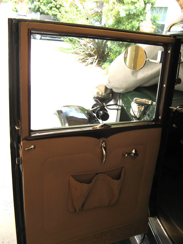

The only place I found it was (perish the thought) Mac's. The part # I bought was A701980HC2 which is the thin stuff that Bill Quiet spoke of. Actually works quite well.
