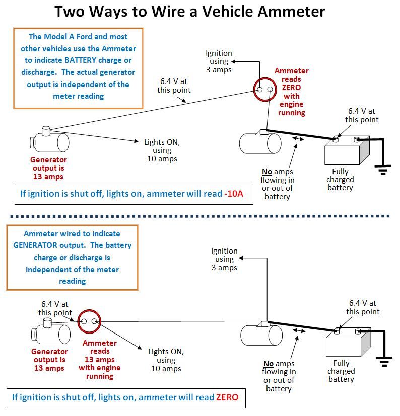

The biggest waste of money is the big "sell" to make you think you need a larger ammeter with an alternator. The ammeter in an A only shows BATTERY charge/discharge. It is NOT wired to show total generator or alternator output.
Even if you had a 200 amp alternator and a light bar with ten halogens on the roof, if your battery is fully charged the ammeter will say ZERO even though the alternator is putting out 200 amps.
You cannot damage a stock A ammeter even if you run thirty amps through it. The internal shunts on the stock 20A and the 30A meters are identical, only the calibration is different. Driving the meter 50% or 100% over-scale will not hurt a stock ammeter. If it were a high precision wound armature meter, like a D'Arsonval or Taut-Band design, over-scale could damage it. But it is not. It is inductive. It works like a speedometer. Henry's cheap design (used by almost all automotive ammeters to this day) uses magnetic flux from the shunt to deflect a non-electrically connected aluminum pointer within a permanent magnet ring.
The stock A wiring will, however, start smoking (think Lucas ) if you run 30 amps through it for more than 10 minutes. Having a dead flat battery will draw ~25-30 Amps from an alternator for about 10 minutes then it will taper to less than 20, finally to zero when the battery is 100% charged.
Generator or alternator, any output rating, there is no difference if you use a 20 or 30 amp meter. The disadvantage to the 30 is it is difficult to "see" a 2 or 3 amp discharge as the needle is less sensitive.

Originally Posted by SteveB31 View Post
MikeK, . . . I don't understand your comment about that the ammeter not showing generator or alternator output. . . Please help me understand what you are saying, as I don't think you are right.....but unlike many others on this site, I am open minded and always want to learn more.
. . . Steve, Does this help? I tried to simplify it as much as possible.

SteveB31,
Another way to look at it...For a normally wired Model A, the Amp meter shows the amount of current going into (+) or out of (-) the battery. The amp meter does not show the total amount out of the generator, it just shows the "extra" amount that goes to the battery after the generator has provided power for the ignition and if on, the lights and horn.
Marc

Default Re: Ammeters for 12v conversions
I understand exactly what you mean. The way it was stated in your first post was unclear, but I get what you are saying. I had never thought of it that way before. thanks

Gosh - I wish I had enough brains to absorb all the knowledge that is to be found on the FORD BARN FORUM ! Being a non-mechanical guy and quite a bit of a 'dunce' about even the basic mechanical workings of the Ford Model A, I appreciate such useful (to me) tools as the scematic diagram that Mike K has posted above.
Thanks so much guys !
