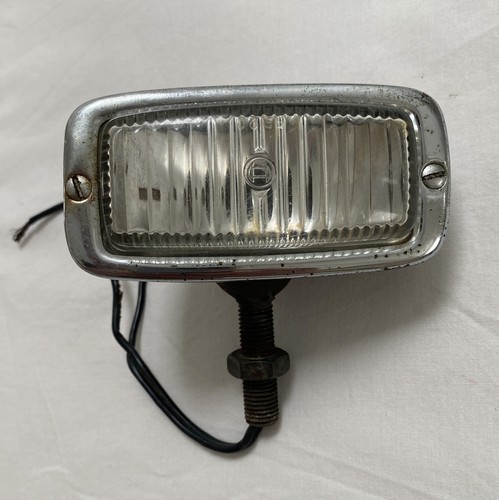

You can find the early 60's VW rectangle backup lights pretty easy AND they are 6V

Re: Reverse lights what are you using?
https://i.ebayimg.com/images/g/rhUAA...p5F/s-l500.jpg
ActionYobbo 10-26-2025 08:30 AM
Great stuff. I will make some brackets and find some VW style lights in 12v. I plan on using a brake light plunger style switch to activate the lights using a relay wired for ground switching like a horn relay. Putting the shifter in reverse pushes the switch in and closes the ground circuit activating the relay and turning the lights on.
