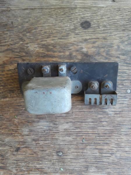

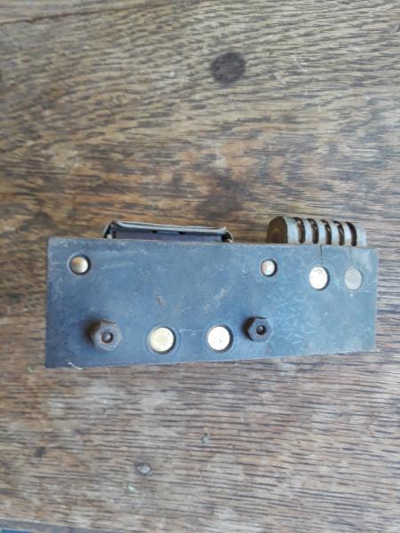

This what you're looking for? I took it off my running '39 p/u when I converted to 12 volts.

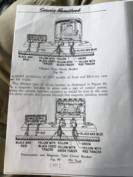

05-24-2023, 06:11 PM | #7 | |

I finally got my picture loaded but was way slow. Thanks for the better picture. I noticed yours was a Vanpelt Sales. I much prefer an old model unit but will check Vanpelt Sales.

Re: Coil Resistor
Sorry it won't work for you. Mine has been gathering dust on the shelf and has been to at least 4 swap meets without anyone showing any interest at all. So it's bound for the trash bin. I've been thinning the herd as well as of late and in the process of a metal run. Hate to get rid of something that might be of value to someone down the road. But at 72 I can't keep everything and leave it for my son to deal with.
