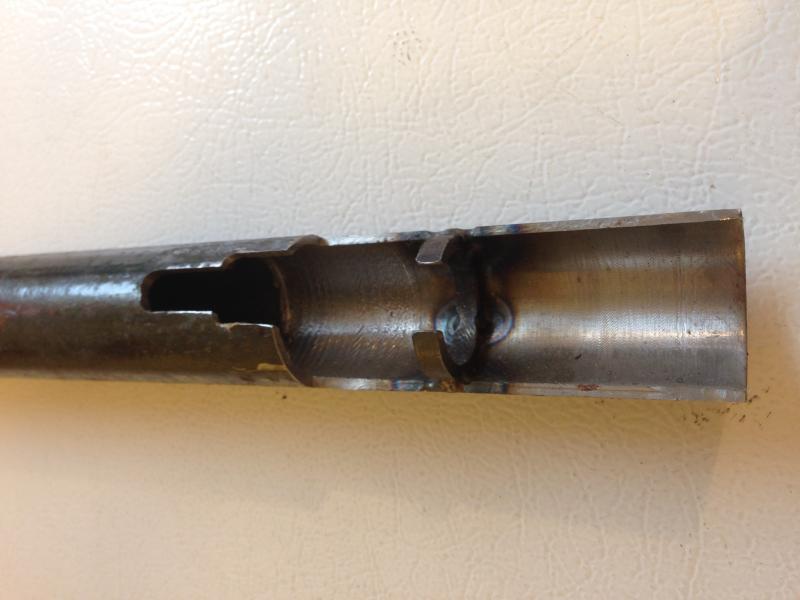

Default Re: Shifting transmission
Originally Posted by Brentwood Bob View Post
Be careful with the big spring. It can be a real eye opener if it is not contained.
Bob
Bob; I learned that lesson. The first tower I took apart, the spring flew out, and it wasn't found until moved, many years later, before I found it.
I now have a tool, which is safe and easy, however I still wear a face shield, and am on full alert.
