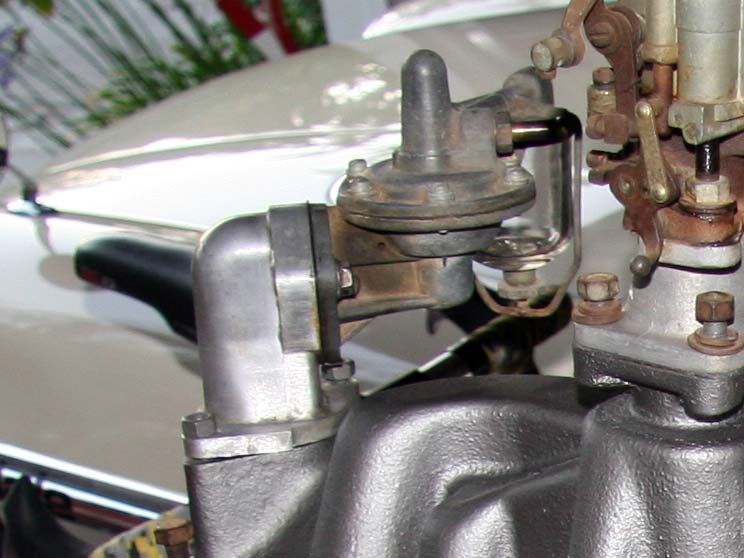

When mounting the fuel pump to my 8CM, the rod seems to be about 1/2" too long because when the cam is as full rise, the pump sits about 1/4'1/2" off the intake manifold. The rod is seated in the receptacle of the pump. Is there something I'm missing here?
I got the engine disassembled but this is definitely the rod and pump that were on it before. The photo does not show the pump raised up but maybe there's something else obvious?

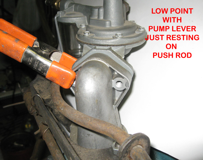

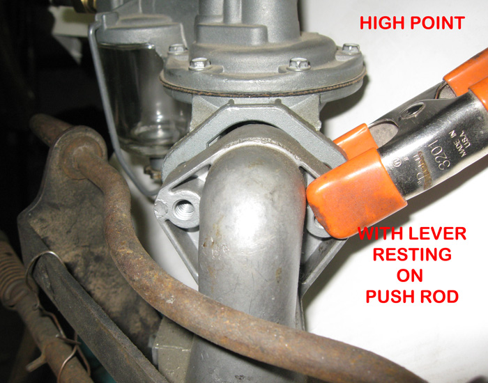

Old 02-09-2011, 12:52 PM   #20
51 MERC-CT
51 MERC-CT's Avatar
Location: East Hartford, Ct
Posts: 5,898
Default Re: Fuel pump oddity
Originally Posted by koolman View Post
51-MERC-CT,
It is an Offenhauser for the latter block. The engine was rebuilt before I bought it. The push rod is new, pump and stand are old. Are the 8CM and 8BA pumps interchangeable?
DK
The 8BA pump will work in place of the 8CM double pumper. ( that's what I use)
Something to try- Turn the engine to #6 cylinder TDC. Lining up the rotor to the cap is close enough (this puts the fuel pump pushrod at it's lowest point making it easier to install the pump)
