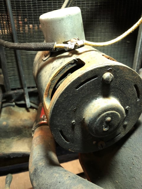

All the threads I have read regarding 6 volt positive ground generators talk about adjusting the third brush to increase or decrease voltage output. Looking at he generator installed on my 29 Tudor all three brushes are self adjusting spring/pivot mounted. Does any one recognize this generator and is the output adjustable?

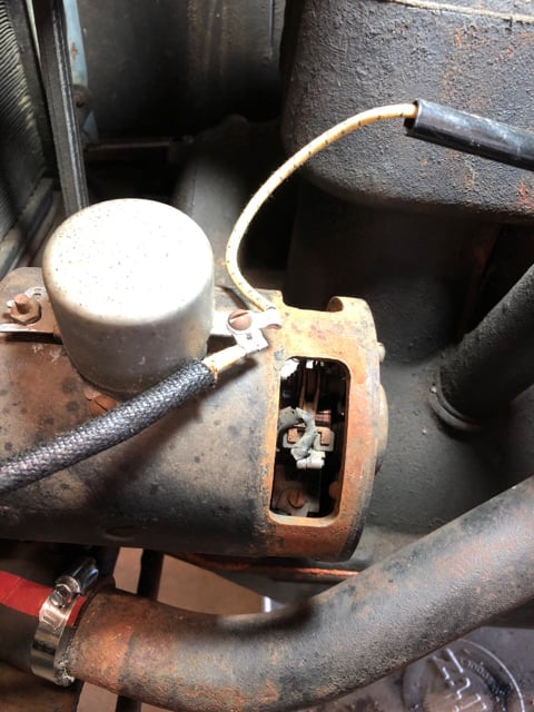

It's a 29 generator, look closer , one brush pivot is mounted on a ring, that's the third brush you move the whole assembly, brush, pivot post, spring
Probably the one in the picture

I agree with both answers. I believe the adjustable brush is the one most visible in the picture. Don't let a metal screw driver short out to the generator housing while adjusting it.

Moving the brush in the picture is correct, and moving it up lowers the amps. I'd adjust for 2 or 3 amps for average daytime driving. More amps cooks the battery and evaporates the water.

You nailed it, finally got back to the ole girl today and was able to pivot the "third brush' the one in the picture, and get the amperage to +4 amps with the lights on. Would not have known this was the brush to pivot with out your help.

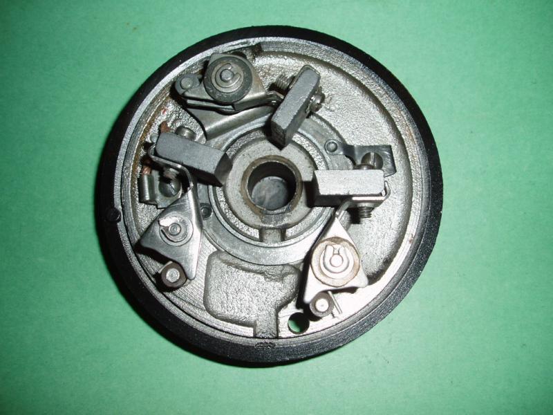

Here is a picture of a 30 end plate. The top brush is the movable one. Yours may not move because of rust and gunk.

See my picture that Mike posted in #13. Moving the middle adjustable brush up lowers the output. When you move it up, you move it closer to the ground brush, so this lowers the voltage sent to the field windings.
