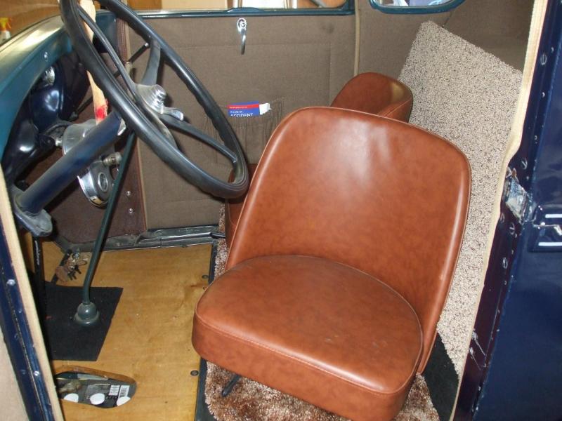

Dave,
My battery "HOLE" is cut on a different angle on my '29 Coupe. Boards are new lookin' & varnished nicely. Bill W.
