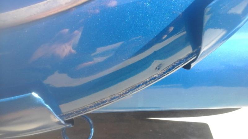

here is what I have, it seems like there is something that should grab the big ring and cinch up but there is nothing there20180112_130338.jpg

There is no 'latch' at the bottom of the tire ring. You are missing the round circle on one side that you are suppose to use to pull the ring out, so that you can remove the ring. The ring is held on by it's spring steel shape. Under the cap should be a lock. Other than 3 lug nuts and the lock in the center under the stainless cap, there is no other 'latch'.
OK so if I'm understanding correctly there should be 2 rings 1 on each end of the tire ring?

There is only one ring on the tread cover, exactly as you have it. The ring helps you to fit the tread cover onto the tire and remove it. You start with the end without the ring. There normally is a rubber gasket on the exterior of the face cover that helps secure the tread cover, but this gets really hard after 80 years. Mostly the tread cover is just held in place by the tire itself.

What you have is correct. The outer ring (Band) has a finger loop on one side only. The 36 does not use the strap around the tire like the 35. There should be multiple slots around the inner cover that are used to attach the chrome strip (unless you have a standard cover which does not have the chrome). If your tire is too narrow, the band will look like yours and cover too much of the inner cover. Tire too wide it wont cover the edge of the inner cover.
