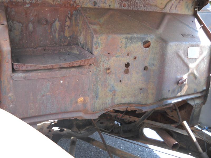

Will a '35-'37 Ford pickup fire wall on the left fit in a '37 Sedan on the right, or is it to narrow? Thank you for the information.

1937 Ford was the first year for the battery box on the firewall. Your replacement firewall does not have a battery box for starters.Measure the width of the replacement and compare it to your sedan.

That would be a logical answer if I had one in hand. I want to buy the ' 35-' 37 truck firewall to replace the original '37 Tudor Sedan firewall. I just don't want to spend 3-4 hundred dollars on something that won't fit. I guess I wasn't clear on my original post, sorry.

Truck firewall is not as deep as passenger car,

About 36 wide at the bottom and about 40 wide at the top (at the first recess) for '36 PU

Thank you mike, exactly what I wanted. Only took 5 days. Thank you again.

They are different from front to back. As I said they are not as deep as car. I am using one in my 34 because I need to set engine back, to install 8BA with a Blower. Thank, John. p.s. You can call me at 904-879-1803.

You don’t say …. But if your goal is to have a ugly battery box free firewall?
Try 40 pass car.

Wouldn't it be easier to remove the battery box and patch over the hole?

Just puttin what iv seen out there to help … but yes that’s what id do because I can seamlessly put metal together….the wall in my 35 is 2 put together.
