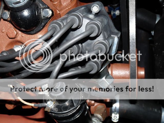

jdl 08-18-2012 03:53 PM
Re: distrib. install
I used a rubber elbow on the vacuum advance & a plastic tee at the manifold wiper hose. I removed the coil bracket and bent it slightly in my vise. I used the stock 8BA plug wires.

bk53 08-18-2012 04:08 PM
Looks familiar! my belt (f100) is actually much closer. I disconnected the coil and put it back after the install. The rubber vacuum elbow looks like a good idea. what steps did you go thru to tune it up? For instance can I skip setting the points? I'm interested in anything you have to say about it.

jdl 08-18-2012 04:33 PM
PS nice looking ride in your avatar.
Thanks,
Bill
Well, it runs great! noticeable increase in power and better gas mileage.
as far as setting it up Richard In Florida was very helpful with his instructions. point dwell is about 30*, max mech. advance 18-20* + add 6-8*vac. advance.
Richard has a nice pdf on this, give him a p.m.
