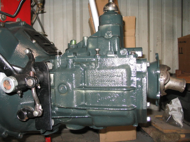

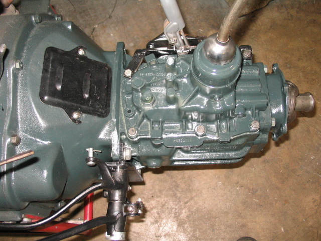

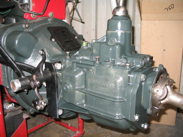

MAG 06-20-2010 03:24 PM
Re: F150 tranny with overdrive
4 Attachment(s)
I installed one in my 30 Town Sedan and like it very much. In spite of what you hear, if a AA Bell Housing is used, no cuts are required on the crossmember. No modification of the brakes. The rear radius rods, drive shaft and torque tube must be shortened approximately 1 1/2 inches. considerable machine work and fabrication is required. If a kit with every thing requied is available it would make the job a lot easier.

MAG 06-21-2010 03:27 PM
Originally Posted by Kirby1374 (Post 31858)
Mag, What clutch/flywheel did you use?
Kirby,
AA Bell housing, AA Throw-out Arm, AA Throw-out Collar, Model A Throw-out Bearing, Model A Flywheel, Model A Pilot Bearing, Model A Clutch Assembly, 49 Ford Clutch Plate, Model A U-joint,, Model A Gear Shift Lever.
