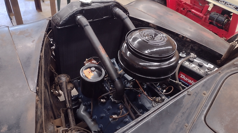

Here are my hardware parts awaiting cleaning and painting. Only one strap is pictured as the other is on the car and you will see that in pic 3. Small carriage bolt heads slide into the fitting on the radiator sides and then go through the strap and secured with nut. Other end of strap is bolted to bracket under the hood. Nothing screwed into sheet metal. The slotted hex head nut and drilled bolt and spring and cotter pin come up through the radiator mounting foot bracket on each side. My Model T experience is telling me to place a small leather strip or inner tube pad between radiator and mounting foot.
Hope this helps visualize what you need.

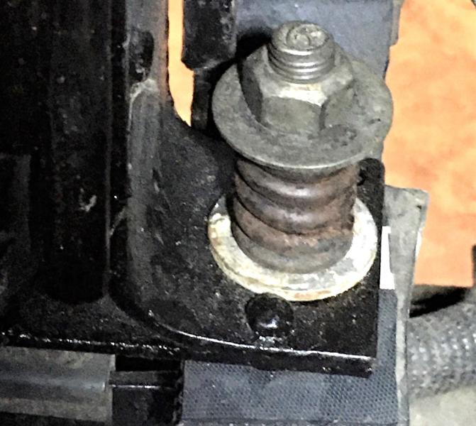

Here are pics of the top and bottom rad mounts, for my '46 Coupe

Mine is mounted like 51woodie's.
Carriage bolt goes head first thru the keyhole shaped hole in the support and into the keyhole shaped hole in the radiator, then slid down the slot and tightened (you might have to reduce the head diameter of the carriage bolt).Radiator feet sit on the tabs on the bottom of the support and are secured with the spring & bolt. Like in this picture from Ford's book.

signsup 03-19-2025 05:41 PM
Re: 46-48 radiator mounting
It is pure Bubba, but it works for me. My springs are weak, the hood will rise and stay open . . .maybe but I don't want my head or hands under there when they don't. So I was figuring something out in my head and was going to bend some rod stock into what I was envisioning. I reached into my scrap metal bin and there was some sort of turnbuckle on a rod that was bent at one end 90 degrees. It was the perfect height. I ground off one side of the surnbuckle and used a inner fender screw mounting point to attach the turnbuckle end and a washer and nut on the underside of the fender and it ain't going anywhere. It meets the hood at an inner sheet metal brace that I drilled a 3/8" hole in and it fits right in and has a little bend to it so the rod can't slip out of the hole. I need to work on the hold down storage, but right now, it folds down and fits between my battery and the inner fender and stays there till needed. I think I can put some sort of wire clip at that location to hold it down a little more factory looking. Only on one side of the hood, but it is metal rod and carries the hood weight just fine.
