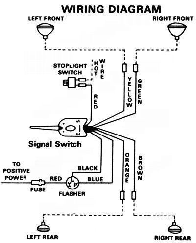

Thodge 08-03-2024 05:19 PM
Re: Signal-stat 900 help
1 Attachment(s)
This is the diagram for the signal that I have. May vary slightly but I think they’re all pretty similar. If you don’t have power at the brake switch I would think the issue is in the car’s wiring harness, not the signal.
Thodge 08-03-2024 05:42 PM
1 Attachment(s)
Sorry, horrible resolution on that first photo. Try this.
Dick M 08-03-2024 07:17 PM
I am looking at the diagram and see the hot wire to the stoplight switch is a separate lead, not wired to the Signal Switch. That could be my problem. I will run a separate hot wire lead to the stop light switch and see if that solves the problem.
Hope so!
Thank you so much for your reply.
Dick M

Bob C 08-03-2024 10:03 PM
You should have power all the time at the green wire from the light switch to the stoplight switch.

Herb Concord Ca 08-04-2024 06:15 PM
Hi Dick, I agree with Bob C, reply number 6, you should have 6 or 12 Volts on the green wire from the light switch all the time. I would start there.
Herb
