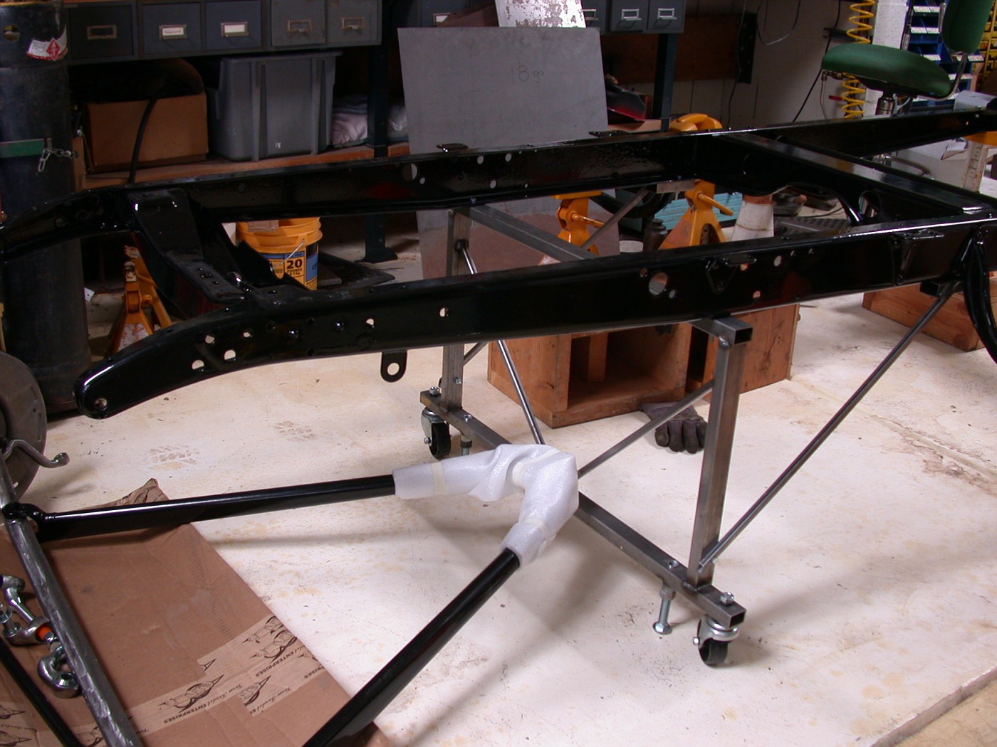

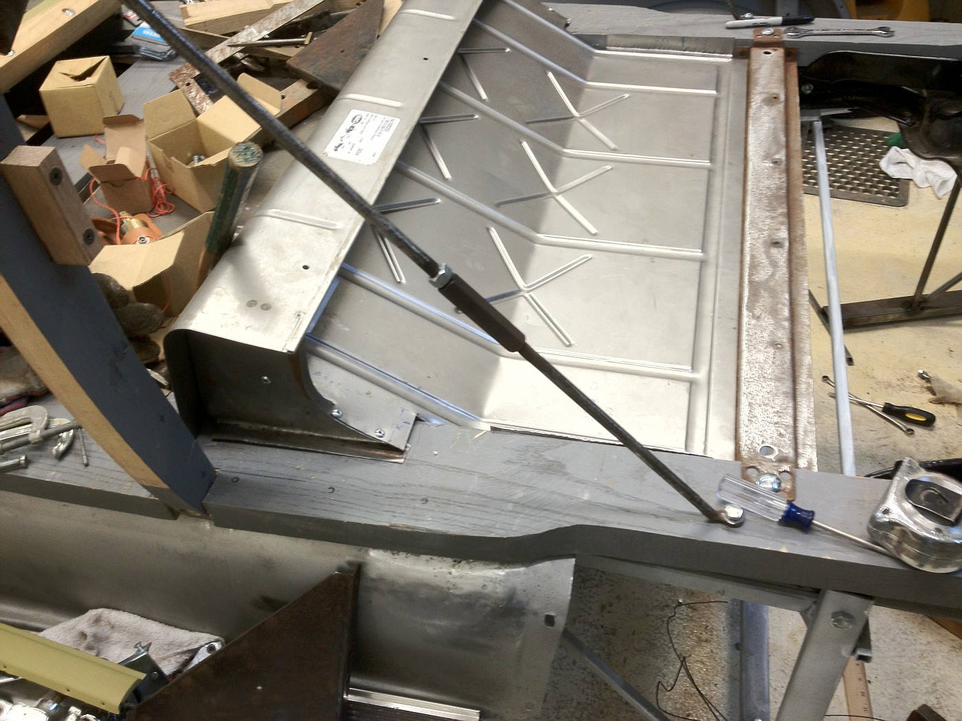

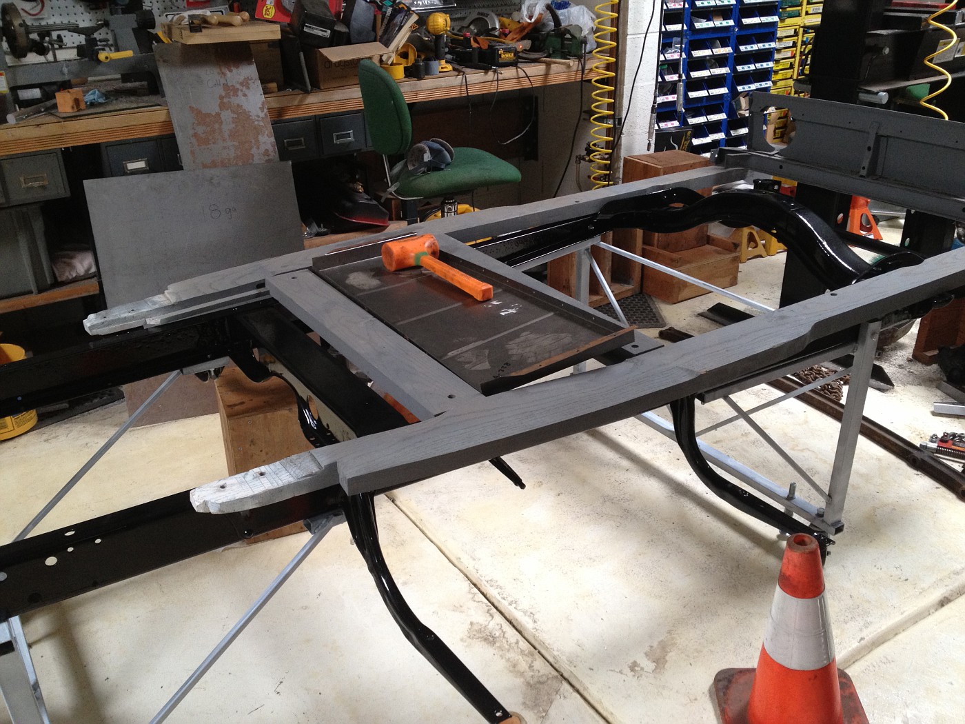

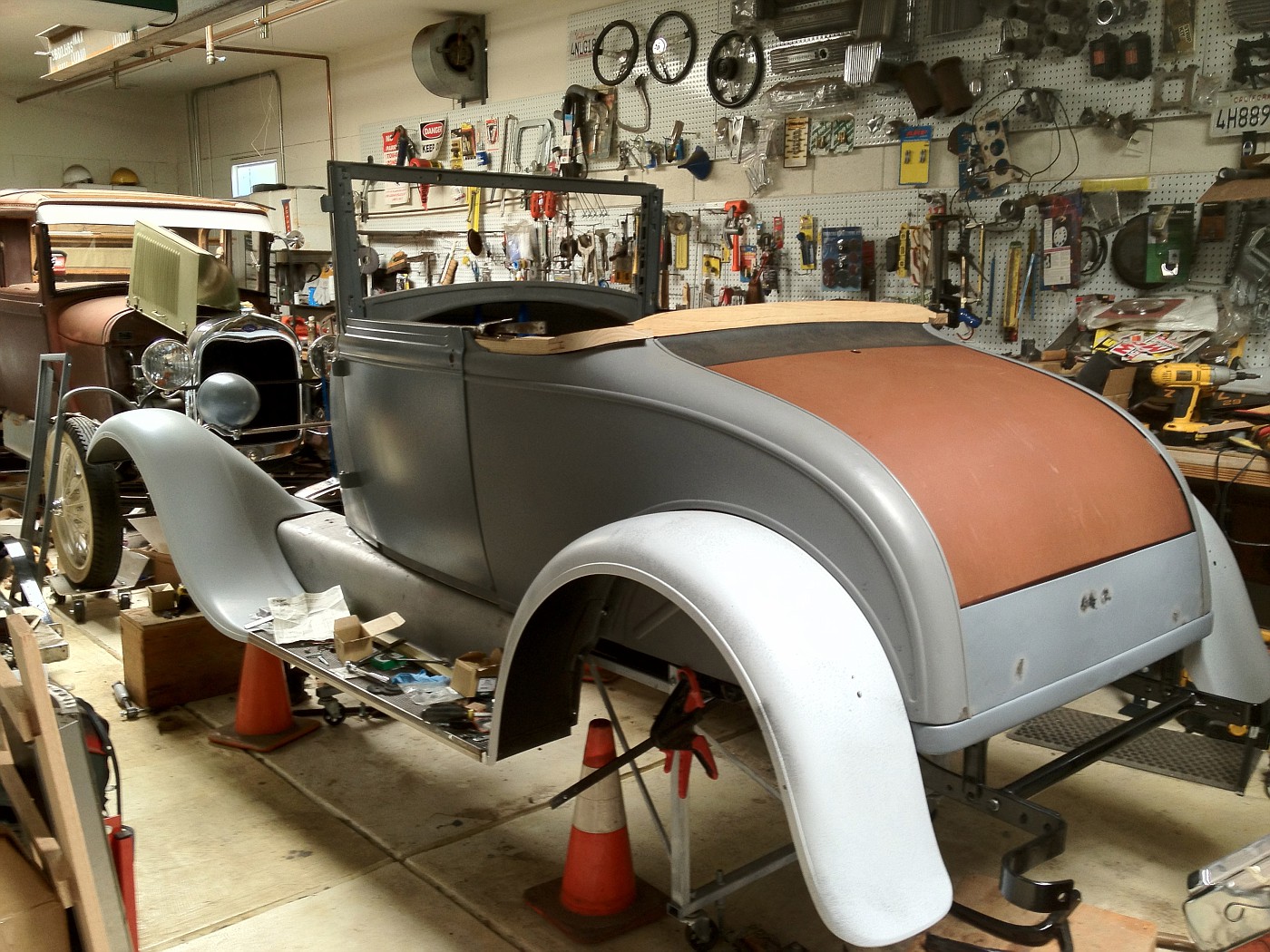

No disagreement here. I made a level platform to set my frame on at a good working height.
https://media.fotki.com/2v5SmFWnxHuj7.jpg
I did not bolt the frame down, but used the body bolts dropped in the holes just to position the rails on the frame. Hope this clarifies my approach.
