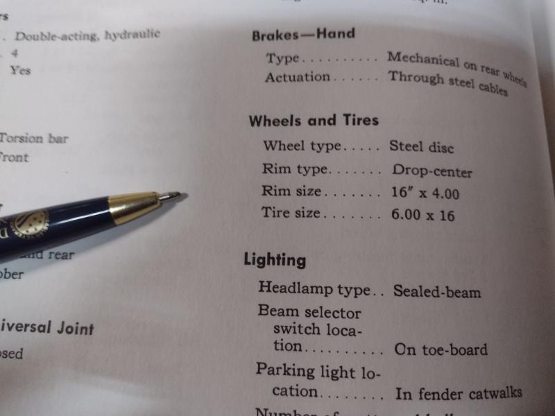

Just had this discussion on a Facebook page. 16" X 4" according to the "green bible" and the 1942,1946, 1947-48 sales data and reference books for Ford passenger car.
1942deluxe 01-20-2024 08:33 PM
Re: Rims
1 Attachment(s)
Attachment 534757
US Mercury is different I think but Ford used 4"X16" 1940-48 to my knowledge.

I believe if you'll go measure BETWEEN the two beads on the '40 & '41 wheels with the STRAIGHT sides on the drop center (as BELOW) that you'll find them to be 4" wide.
https://www.fordbarn.com/forum/attac...2&d=1474306334
I believe if you'll measure BETWEEN the two beads on '42-'48 wheels with one slanted vertical drop on the rear side of wheel that you'll find them to measure 4-1/2" between beads, as seen BELOW.
https://www.fordbarn.com/forum/attac...2&d=1488821504

1942deluxe 01-21-2024 09:40 AM
Re: Rims
Coop, The Early Ford V8 club 41-48 book states the 01A- 1015 rim was used in production thru 1946 which is the rim in your first picture I believe. Three of my 42's rims were date stamped 10-16-41 and were that style. They mention a "sloper" rim was then used. I think that would be the 11A-1015 rim listed as a service replacement in the November 1950 "green bible" which I believe would be the design like your second picture.100% in agreement you measure from the inside edges to determine the width. Did Ford make a change and not update the parts catalog and data books given to the dealers? Possible but I can't find any documentation to support it. The Green bible does list an 8C 1015 rim at 4.5 inches with for the 45-47 trucks. Without looking I'd think that also fits the 48-50 trucks(1948 P/N). Having 1942,1946 and 1948 Ford cars I'd like a definitive answer but that's would I've found so far. I sent a note to the Early Ford V8 club 1942 Ford advisor and he stated my 42 should use the 4" rims....

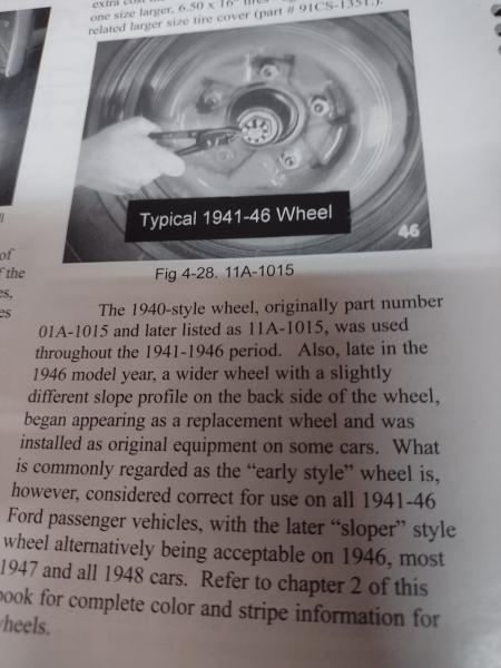

1942deluxe 01-21-2024 11:37 AM
Re: Rims
1 Attachment(s)
Attachment 534807
After reading more carefully 1941,1942 and most of 1946 are 4". 47 could be 4 or "wider, 4.5?" and all of 1948 are wider (again 4.5?). I'm leaning toward all of the "sloper" rims are 4.5 inches.

I think sloper rims are not exclusively 4-1/2". I have a mix of straight and sloper rims on Old Rusty and they are 4".
1942deluxe 01-21-2024 02:02 PM
Re: Rims
Mart, good to know. I'm not yet convinced that the parts book and the sales data/reference books are wrong.
petehoovie 01-21-2024 03:09 PM
Re: Rims
Originally Posted by 1942deluxe (Post 2285284)
Attachment 534807
https://www.fordbarn.com/forum/attac...7&d=1705854845
1942deluxe 01-22-2024 03:43 PM
Re: Rims
Per the Early Ford V8 Club 1946-48 advisor they are both 4".
alchemy 01-22-2024 03:58 PM
Re: Rims
Wow, I learned something new. I was always told the straight drop 4” wheels were 40 only, the slant drop 4” wheels were made in 41, and post war they were all 4.5” wheels. I can agree that there was probably a little overlap to use up old stock, but I never would have guessed that they didn’t really use the 4.5” in earnest til 47.
