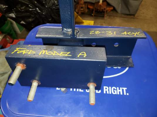

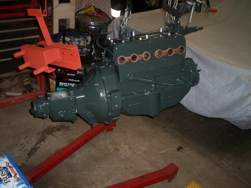

8EL 11-05-2023 07:45 AM
Re: engine dimensions
7 Attachment(s)
Originally Posted by Fat (Post 2267340)
I would like to see. Please post a pic of your car also. Thanks!
Hi, Here is the fixture I made to mount the Model A block to a conventional engine stand. The water inlet bolts through one member and then two pan rail bolts. The pan bolts are through holes so run the bolts through the angle iron from the top and nut them on the pan rail side. You will have to remove the nuts to install the pan. This mounting approach is some what odd, but
the advantage is that full access to the flywheel and clutch is afforded.
Also included a couple of photos in use. This engine was installed with a modern head gasket not requiring sealant, and has worked perfectly since installation. I thought I saw something to this end recently on the forum....
