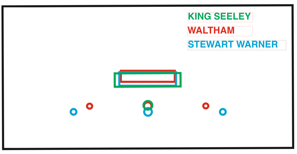

One can recognize a King Seeley just by looking at it.
It does not have screws to attach the face plate to the frame (four tabs, two on each side, are used) and the odometer window is so wide that it goes through the 3rd Gear region of the face plate.
http://www.surfacezero.com/g503/data...t_20_08_28.png

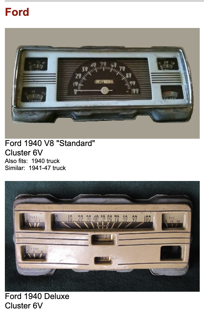

fordyford 02-12-2023 04:10 PM
Re: Speedometer face plates 1940-1946
I have considerable experience with these 1940/47 truck/commercial faces. The only rectangular one ever used in a passenger car was in 1940 standard and a sedan delivery in 1941. All 1942/48 passenger cars were round.
The King Seely is very uncommon.

htc 02-12-2023 05:49 PM
Hello Fordyford,
That is interesting and new to me.
So only the the trucks had the rectangular speedometer faceplates?
(except the 1940 standard and the 1941 sedan of course).

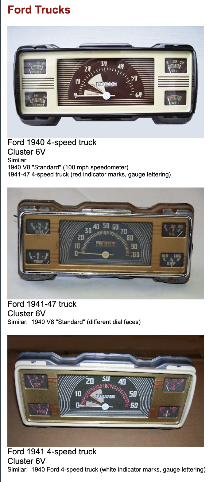

htc 02-12-2023 06:15 PM
Hello
So I did some research and had a look at the website on identifying instrument panels:
https://sites.google.com/site/identi...clusters-1940s
I found this
http://www.surfacezero.com/g503/data...V8_cluster.png
and this:
http://www.surfacezero.com/g503/data...47_cluster.png
This confirms what Fordyford said.
As I do not know about Ford Trucks my next question is:
Are there two different kind of trucks:
1. The 4-speed one (60 mph)
2. The V8 one (100 mph)
Greetings
Hans
fordyford 02-13-2023 08:36 AM
Re: Speedometer face plates 1940-1947
The engine did not determine which speedometer to use, the transmission would. Three speed or four speed.
Other things to know
1940 all used a VOLTMETER
1941/47 used ammeters
oil pressure gauges changed to 80 pounds in 1944
the chrome bezel was a 1940/41 thing, 42/47 painted Tacoma cream
