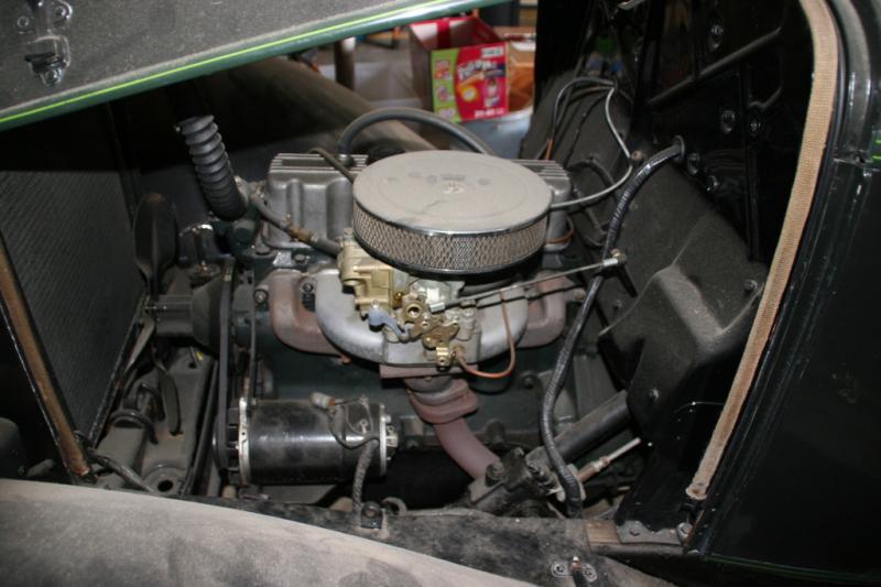

Charlie Stephens 04-28-2021 12:47 PM
Re: Engine question
2 Attachment(s)
My first choice, by a long way, would be a properly rebuilt Model A engine. Maybe with a little MILD speed equipment if you wanted a LITTLE more power.
My second choice would be a ’32-’34 4 cylinder Ford engine. The Burtz engine others have mentioned sounds interesting. Probably not new enough for you.
The third choice is probably the Ford Pinto engine that was used as a common conversion in the seventies. I never liked the way they looked or performed and wouldn’t go this route although it does meet your requirements. Search the archives for comments.
The forth choice would be the 153 cubic inch Chevy II engine or better yet the 181 cubic inch industrial version currently in production. This engine was also used in Mercruiser Marine conversions. This is the engine I have in my ’32 Ford (see photo). It has the same bolt pattern on the back of the block as a small block Chevy V8 and a standard speed shop (or swap meet or wanted ad) adapter will get it connected to a ’32-’39 Ford transmission. Note the ’39 has the best syncros. The ’32-’39 transmission will bolt up to the rear end without cutting. You are going to need to fabricate brackets for the brake (I recommend strongly hydraulic) and clutch pedals. Everything clears and no chassis cutting is required.
You might also post your question on HAMB, https://www.jalopyjournal.com/forum/
Charlie Stephens
