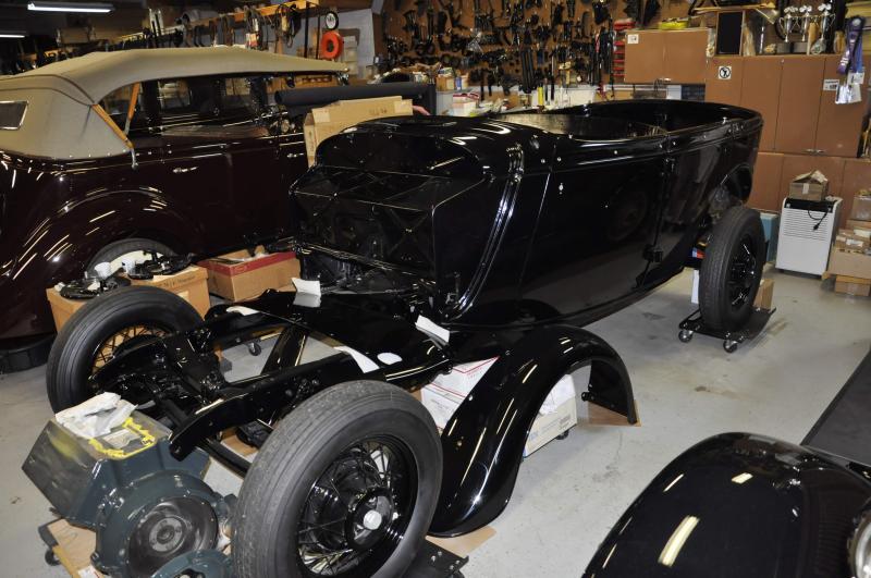

DavidG 02-26-2020 07:28 AM
Re: front header weatherstrip 34 Phaeton
1 Attachment(s)
Mike,
Here's my '33 standard phaeton, also all black, awaiting final assembly.
