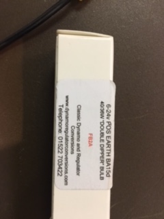

Hunter 02-22-2018 09:41 AM
Re: 6V Quartz Halogen Headlight Question
1 Attachment(s)
Timely discussion. Last night I attended one of my local clubs and we had a great presentation on Model A light bulbs. The fellow that gave the presentation, Luke Chaplin, went over all the bulbs that are currently available and the pros and cons.
The halogen bulbs do pull a lot of amperage and get quite hot. The amperage draw for the set he had hooked up was about 10 amps, I believe. He showed us the brightness of various bulbs using a set of actual model A headlights. The hands down winner was LED bulbs from a British company, see attached image.
The current draw as low and the lighting was spectacular. Very nice and uniform.
He mentioned that the these bulbs are properly designed so that they focus properly, whereas many being sold are improperly designed and cannot be focused.
They are expensive, looks like about 76 dollars for a set, but they are a thing of beauty.

Failed to include the website for the LED bulbs:
www.dynamoreregulatorconversions.com
