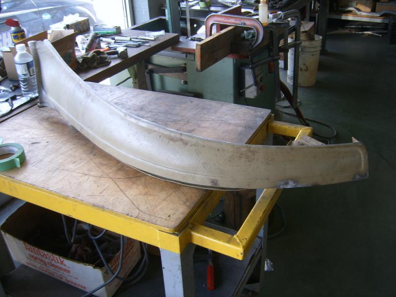

im making my own panels now. so far i have a much nice start then what i got as a patch panel. i used a piece of 20 guage for the first run just to see what i could make it do and i like the results. switich to 18 gauge for the final product.
i used my commie bead roller some conduit and bruce springsteen on the ipod. wish i woulda started working on these in the begining of the day instead of messing with the patch panels.
i made this up in about 20 mins and quite happy once i get the hard line from the step die out i think ill be good to go
http://i130.photobucket.com/albums/p..._4794472_n.jpg
http://i130.photobucket.com/albums/p..._6516962_n.jpg
you can see i started to get the hard line out on the edge. pretty excited about this!!
http://i130.photobucket.com/albums/p..._6542961_n.jpg

Some nice work Brent. Looks like the Coupe had all of the regular weak areas. The Tig does a nice job. I've got to learn to Tig. Only a Oxy-acetylene and Mig guy. Nice to see some metal finishing as well. Keep up the good work.
Here`s some picture of a 30 I`m working on that someone had brazed in sections of the Upper Quarter panel sections.
The Old Tinbasher. John Poole
