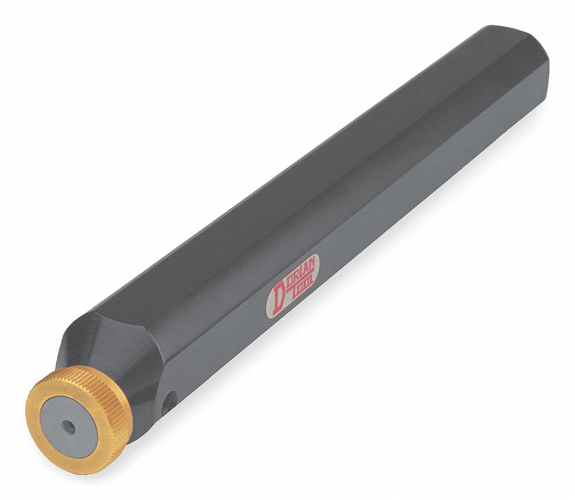

You need an internal straight knurl tool, looks like this:
https://static.grainger.com/rp/s/is/..._AS01?$mdmain$
Run it lightly only on the final bearing race contact area.
