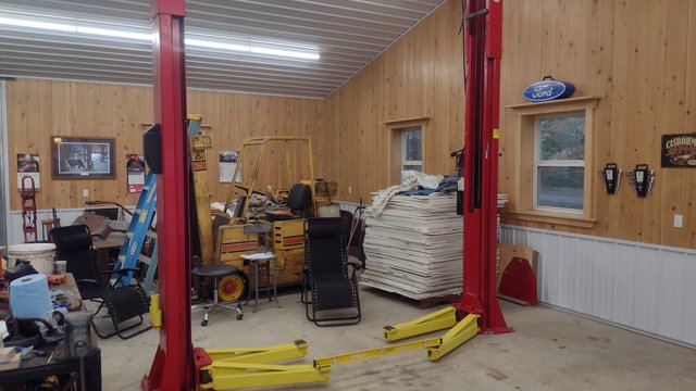

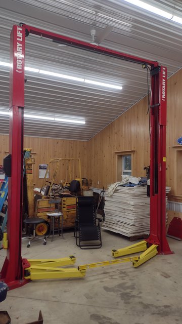

sugarmaker 10-18-2023 12:59 PM
Re: Two post lift opinions
Folks,
Our shop was designed around a large 2 post lift. I was able to snag a used rotary brand truck lift from local tire and car repair store. It's a 12,000 lb symmetrical arm style.
Today was the first actual project. Had the F250 diesel on it to repair a worn steering component.
We installed the lift. Shimming the low side of the floor 1.5 inches due to floor drain slope.
I did look at new ones and I think installed they were about $10k to $12k.
Sounds like a good price on the 9,000 lb lifts.
I am a little concerned that this tool in the shop makes me take on more projects????:)
Regards,
Chris and Cheryl

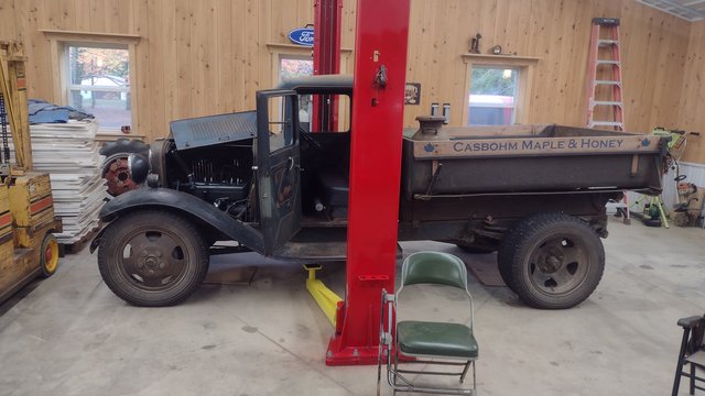

sugarmaker 10-24-2023 08:39 PM
Good discussion on lifts. Still learning about the used lift I installed in the shop. A tool that most of us needed years ago and are now getting these for our work. They are available in a variety of shapes and sizes. Like most things in mechanics, do some research, set some goals, Check the specs, and do some shopping. I am looking forward to using this tool to save some hours crawling around on the floor under vehicles. John Kelley would have appreciated having this lift when we were working on his 42 Ford in the shop last year too.
https://i.postimg.cc/T2Svs6q9/IMG-20...-165036585.jpg
https://i.postimg.cc/WzRYhQ1S/IMG-20...65042795-2.jpg
https://i.postimg.cc/W33cGDgz/IMG-20...-174306814.jpg
Figured I better get this picture in there since Robert posted his car and lift.
https://i.postimg.cc/cJWFyVJN/IMG-20...-160225560.jpg

GB SISSON 10-24-2023 09:51 PM
Chris, Is that in your new building, or off to the side in the big shop. Dang, it sure looks nice in there. You run a first rate operation there at the sugar works.
sugarmaker 10-25-2023 06:32 PM
GB,
The lift is in the big shop in the high bay area. The new mini shop is already packed with tractors of various sizes. (8 in there, plus my lawn mower show equipment). It only has 10'-0" ceiling height in the new building. It definitely has freed up some space in the big shop too. (Humm maybe can think about another toy at some point!)
The 2 post lift made it a lot easier to work on a rolling stool, at just the right height, to complete the worn out tie-rod end on the F250 (FYI: weight on that truck is around 9000 lbs).
