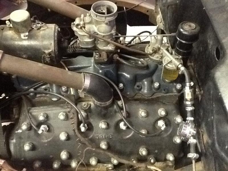

I'm running a electric pump back by my tank pushing fuel thru the mechanical pump because the cam lobe for my pump rod is worn out. Is there anything I can do to the mechanical fuel pump to make it flow better since there isn't a rod inside it and not working any longer? I'm trying to keep it looking original. Ohhh it's on a stock single carb 59A-B.

If you are going to have an electric pump, why run the gas thru the old fuel pump where it does nothing but pick up heat?

Old 06-28-2015, 03:06 PM   #14
13clicks
Join Date: Dec 2014
Posts: 10
Default Re: Flathead electric fuel pump
Here's my setup in my 36 5window.

Those round Spectre pressure regulators are junk IMO.
Just trying to keep it looking as original as possible.
Agreed and will get a better one later as this is just here to solve the problem now. I'm also going to hide the better one when I get this thing dialed and running right. Just a quick fix for now.
