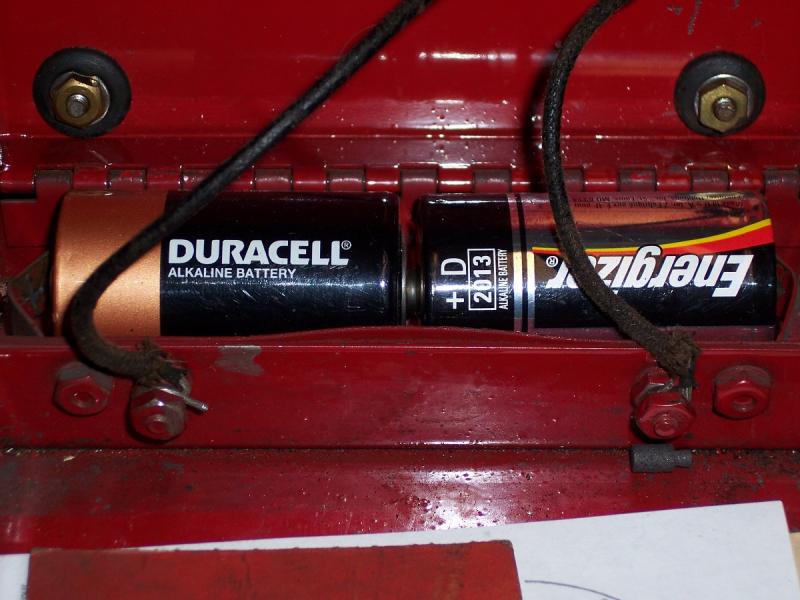

Here is a picture of mine. Are you sure that the battery contact clips on each end aren't missing?
Bob

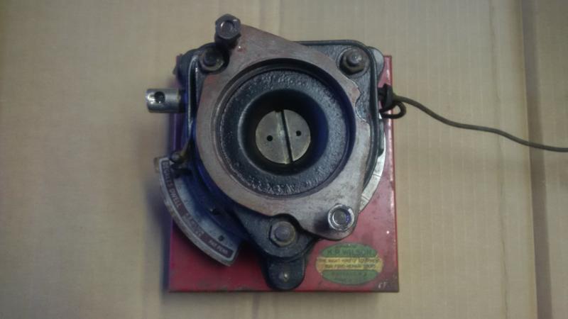

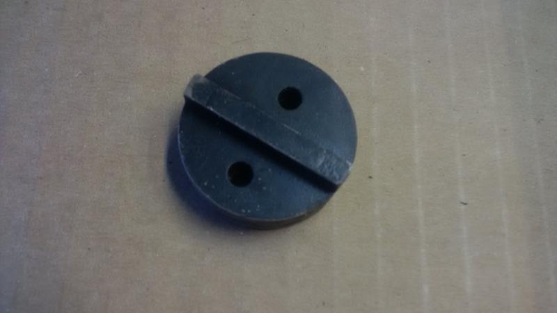

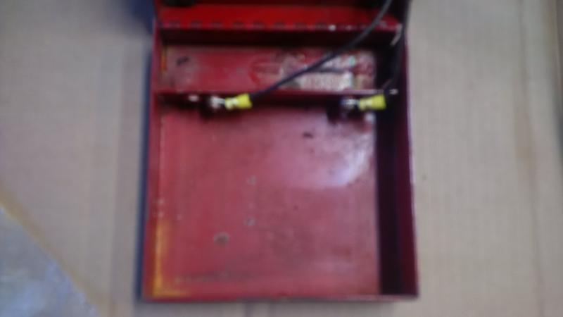

Heres my unit, purchased it about 30 yrs ago, usually when I buy something I write the price paid on it, $25.00, must admit I didn't know what I was buying, just recognized the KRW make and at the time I ran across this I hadn't bought anything at that flea market, was Dunkirk I think. Am guessing it might be worth more than what I paid, I try to keep my shop contents up to date with item list & value of what's in there, what would be a good $ value on this. Also is this a complete unit ?, anything missing ?
That´s a nice complete setup with the 2-bolt adapter and the adjustable dwell scale.
Think i have 2 of the cam slot adapters in mine.
Have to check what the marking on them says..
What you have there is the best version so should make you some good money...se them go for high $ on Fleapay.

Thanks for the feedback, guys. My unit appears identical to Bob/Ohio and oldasi's. I'll have to go back and figure out why 2 D's are too short. Anyhow, the pics helped me understand the wiring in the box. Although fairly dirty from long storage, mine seems to hardly have been used. I'll post pics of unit and instruction sheet (which is original, almost mint, and printed by KRW). By the way, have your units got s/n stamped inside bottom of box, like mine?

Mine is stamped in the bottom left front corner of the box, 41-F-2993 U.S.A., and my instruction sheet also has 41-F-2993 printed on it. As far as 2 D batteries being too short, they will seem to be as the contacts for them are not at the end of the battery tray, they are next to the wires as you can see in my picture.
Bob

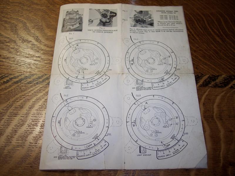

Here are pictures of my instruction sheets that you suggested I post.
