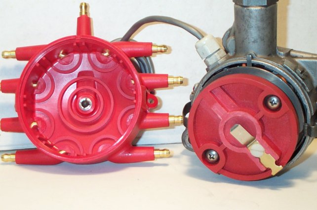

HEI triggered by Mopar magnetic input (no condenser required ).
MSD cap and rotor;

Bill M I like your distributor, This type of modification to the old Crab makes it a much better unit than the MSD unit because it still uses a vacuum component for distributo advance under load and cruise. Those that run without vacuum have a rich mixture during cruise witch waste fuel and contributes to cylinder ware, by washing the cylinder walls with excess gas

BillM, Where can I get that dizzy thats shown ? Thanks Moe

It's basically a DIY deal. Too many mods to the pickup and selective fit to bore the reluctor to fit the cam to make it kit of parts to install on any distributor. And I don't have the time to do it for others.
See my website for the details on how I did it. I tried to include enough info for others to duplicate it; although it requires the use of a lathe at the least.
