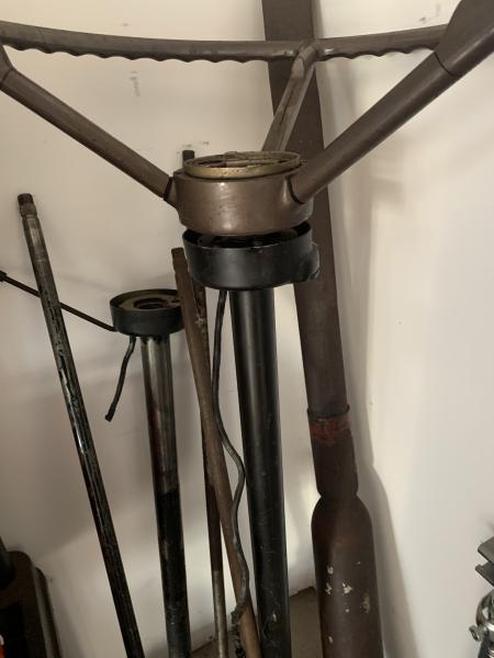

I was noticing on my steering column, and steering wheel(300) that the gap between the wheel and the column has a large gap.

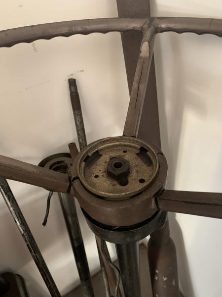

I checked an old unit and the gap seems to be the same.
Place the wheel on and tighten down... the nut only goes so far and is basically flush with the steering shaft it goes onto.
checked the old unit in the corner and its the same.
Was wondering if the "gap" should be closer and tighter?
Maybe I am over thinking all this.. but also....

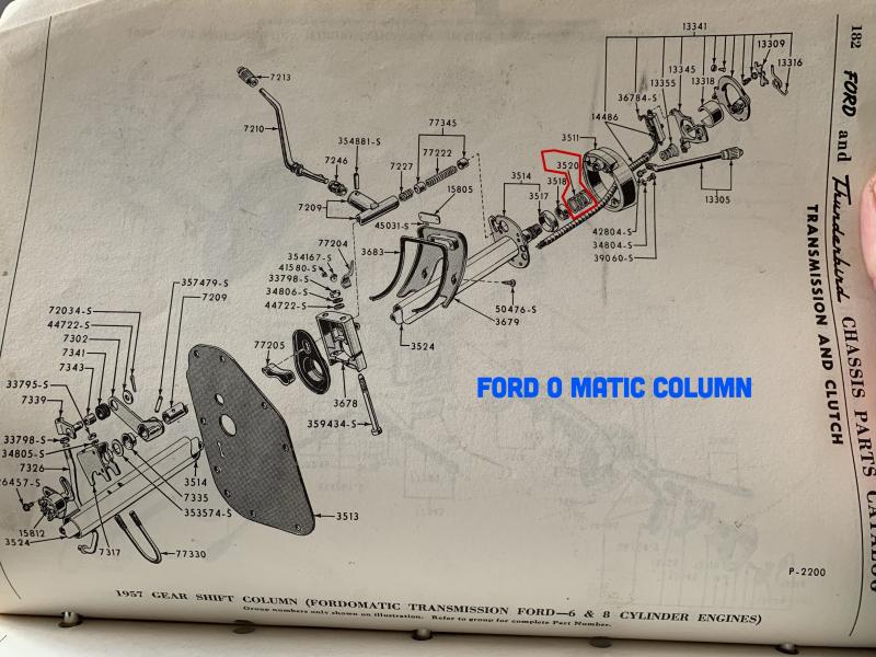

There is a spring in a FORD- O-MATIC column (pn3520) which doesn't seem to be present in a 3 speed man. column.
I have it mine and have taken it out and put it back in.... seems to have no effect on anything.
Am I wrong on this?
I can simply loosen all the hardware on the column and move forward about 1/4 inch.... But I am not sure it will make any difference.(to try and tighten the gap)
I will attach pics.....
looking for clarity/
My Column and wheel in the car.

The stock unit in the parts pile.... uncracked and its a FORD-O-MATIC unit.

Pics of the Ford Manuel showing a FORD-O-MATIC column and a standard 3 speed man. column.

My 58 is long gone so I have nothing to look at, doesn't the outer jacket just slide up after loosening the body clamps/hold down.

It does and that's not a problem...I just don't have any ref other than the old auto column in the shop.. and the question of that spring....PN3520... which is in an auto column and not a Manuel column.... I just can't seem to find a ref. for it in several Manuels I have.
At the moment.I have the spring in my man. column and it doesn't seem to affect anything... except keeping the centre collar in place.(pn3518)

The steering shaft is solid to the box and the wheel is tight to the shaft, if nothing in the signal switch is going to be damaged I would try sliding it up a bit on your spare and see what happens.

All 3 of my auto columns have the spring. My original wagon is a 3 on the tree and has a gap of .090. I popped the wheel off and it has the same spring. Pretty sure it did. Its is for holding the center collar tight in the bearing.

Well... it only took 10-15 minutes to slide the complete shaft into place.. and it helped even more with a friend helping..... that spring wants to keep the shaft away from the gap..... anyhow,...... loosened all, set it,... and its now a 3/16 like factory.
I just found it funny there was no spring diagram on on the man. columns. only the Ford O matic diagrams.

Put the spring back in between the split ring on top of the column bearing and bottom of the wheel. That spring keeps the steering wheel centered in the hub and if that spring is missing, The steering shaft will rub up against the oil tube in the steering gearbox and cause leakage at the center.
