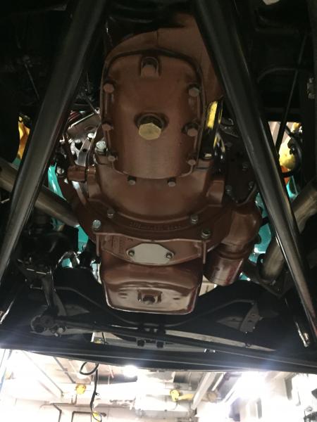

PeterC 11-27-2020 12:09 PM
Re: 39 trans
1 Attachment(s)
Originally Posted by rotorwrench (Post 1956811)
The LaSalle 3-speed was the transmission preferred for high torque back in the day. Ford referred to their 3-speed as the light duty transmission for pickups up through 1951 or so.
Yep re LaSalle - my 39 Cadillac powered Coupe had a LaSalle as you see in the Picture - I loved the sound of those gears in 1st and second!
