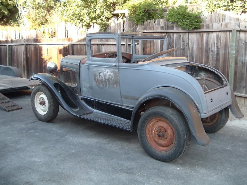

The wheels came and went on a car I got rid of years ago,but have a chance to get them back. I know they are not "newer",and are narrow. From the pic,any guestimates? I'm just contemplating spokes on my roadster,or steelies.... Either way,i'm getting them. Thanks.

They look a lot like the wheels my stock 46 had---they were 16", I think they were made in 15" also ---Mercury??

I believe Fords from 40-48 used the same style rim. I've got a few of these myself I use as garage rollers.

x2 on the 16" for '40 to '48. Prior years were wide fives. I think your right about the 15" Mercs, but if I remember right it was '48 only.

The basic design look like Kelsey Hayes wheels that were used on many Willys vehicles.

I think that the wheels are 1940-48 Ford 16 inch. The 1949-51 Mercury 15 inch wheels had the nobs for the hubcaps to snap on the outside

Those look exactly like the set I have in the shop. They were on a post-war Merc. They were also identical to the wheels that were on a 41 Continental, as they were once used as rollers for that project. There may be a wider version for Merc and Lincolns, but nothing I can raise my right hand to.
